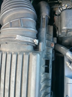

I did find this bit on the air filter housing that looks like it should have a hose, is anything missing? Just by the right side of the jubilee clip.
