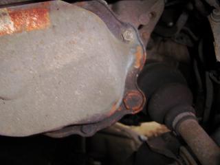

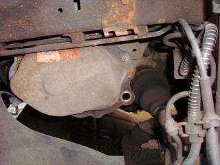

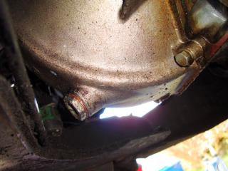

Gearbox oil changed at 105,175miles. Went ok, not difficult really. The drain plug was 21mm and the fill/level plug 19mm. I used a 16mm Cu washer but a 15mm may have been a better fit. I will be doing the job again in a month, the old oil was dirty for 100k.
21mm Drain plug on left
19mm Filler/Level plug next to N/S driveshaft

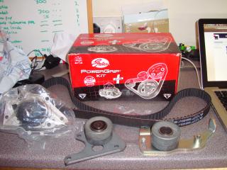

Also my timing belt kit has just arrived. I'm nipping out to get coolant, 11mm half moon spanner, M8 bolts and 6mm threaded bar. I'll be off to play afterwards, I'd like the whole day to mess with the cambelt. ETA on strut tops is the 8th.

Quite soon after the last post. I'm just having a little study of the cambelt job. I've done it before on an XUD9A, which is basically the same, but it was RWD so access was a lot easier. Anyway this is what I'm thinking at the moment.
1. Take car for a drive, get it warm.
2. Crack off crankshaft nut and drain coolant also remove anything in the way, e.g. airpipes.
3. Remove starter motor (I know it's optional but I want to see what I'm doing)
4. Make locking tool from 7mm tube I found lying about and lock flywheel.
5. Remove covers and possibly jack up engine at this point (undoing top mount at the same time)
6. Lock up diesel pump and cam.
7. Remove old belt, tensioners and water pump.
8. Put new bits on and put back together bearing in mind torque, tension and threadlock.
9. Unlock engine and turn by hand several times.
10.Replace covers, put engine mount back together and refill coolant.
I think I'm all ready. I have my socket set, jack, axle stands, new half moon spanners, threadlock and locking kit. Any advice before I get stuck in please?

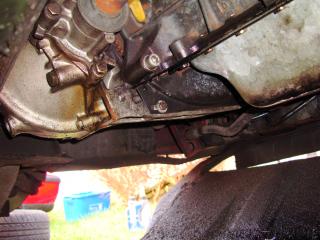

Timing belt is going ok. The covers are all off, 11mm back bolt wasn't a problem with the pipes off at all. Crank shaft nut is loosened and the alternator belt is off. The only nuisance at the moment is that one of the starter motor bolts, hex headed one, is knackered. I'll be doing my best to extract it tomorrow for a while then trying to find the flywheel locking hole blind if I don't succeed. The old belt is actually in decent condition compared to what I thought, not cracked or dry at all.
Does anyone have a good picture with the starter motor removed to give me a better idea where to look? I had a feel but nothing came to light.

Just found the timing hole so no need to remove the starter motor now. I went out with my torch and a drill bit to have a poke, found it really quickly. Going to call it a night I think the worst bits are over with now.

no need to remove the marter stoter elma,elma wrote:Just found the timing hole so no need to remove the starter motor now.
just use a long length of kunifer brake pipe , bend it in the right places so you can point it in the right direction from underneath and up behind the marter stoter
as you can see the hole in the crank case looking up behind the start and from underneath
