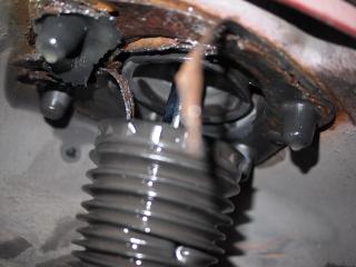

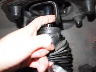

Cambelt I am a bit concerned about, it's due on mileage and on time plus it was sat for a year so should be done regardless. The History with the car confirms this.
The strut tops really scare me. N/S looks like this. The light is from a torch underneath
The O/S doesn't look so bad but the rubber is falling apart.
Maybe I'll put off the track rod ends, tyres and tracking in order to do the cambelt and strut tops faster. I am in the lucky position where I have a spare engine so I guess I have been a bit more worried about bending the bonnet.

Those strut tops do look a little past their best Elma. Are the base plates solid and can you see and feel rust under the rubber just below the sheet metal dome? If it's all gone badly crunchy under the done and the baseplate is distinctly thin in places then there is a cause for concern.
I'd be very tempted to to strut tops and cambelt/waterpump as a priority...

The N/S is all weak and rusty. I daren't touch it at all. When I bought the car I thought it wasn't to bad but when I got home I played with it a bit with a screwdriver and it just disintegrates. The O/S has intact metal but the rubber is worn and perished, it shows no sign of metal failure but needless to say I don't trust it. I guess the cambelt is in similar condition. Decision is made really, looking at my shopping list from earlier.

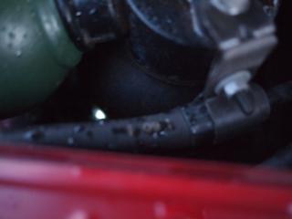

Came across my first real tricky job yesterday. Bad enough that I didn't even try to do it. I didn't expect the nut on the front brake hose to be a particularly big ordeal. By the time I'd cleaned around it and could see what I had to turn I wasn't very happy. It's been mishandled, probably, in the past and I've gut a rusty lump with nothing to grip. I'm a tad concerned, even with a flaring tool I don't really see where the pipe goes or the access to fix it. I'll post some pictures later, didn't take any yesterday as I was too busy panicking. Really going to need some advice and maybe even help with this one, I'm frightened to ask a garage too as they probably don't have Citroen flaring tools and could make more problems for me. MOT is sometime towards the end of January so this is Priority 1 with strut tops and cambelt.

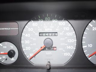

Engine oil just changed at 105,129miles. Gearbox oil needs a square socket so I'm off to get one now. No pic of Brake line yet as camera battery not playing today.
