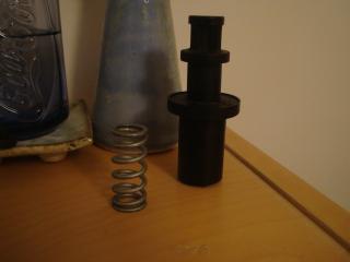

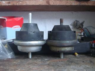

It is quite squished, with them both on the bench the new one is 1inch taller. I'll picture them later this morning when I swap them.

Greatelma wrote:It is quite squished, with them both on the bench the new one is 1inch taller.

This is the old mount vs the new one, squish clearly visible. I bought the new rubber from CES, a local factor. I haven't noticed any difference in driving, but I'll be keeping my eye on the mount and hopefully now no more issues

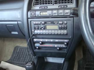

I've also reinstalled the original stereo and done the brake pedal mod. The stereo doesn't really like turning down, but other than that is great. I haven't driven it yet with the pedal mod. Ive been taking out the fake wood as well, it leaves behind glue goo that takes ages to rub off. It comes off from flat bits nicely in the end but I still need to work out getting it off the dimpled areas.

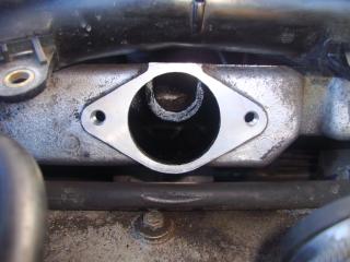

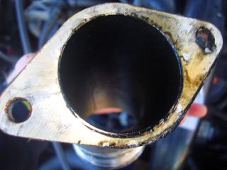

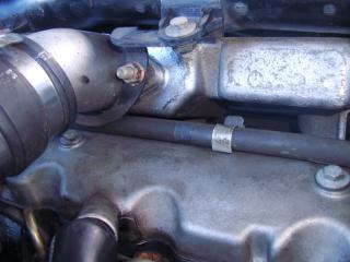

I'm trying to find a gasket at the moment to go between the inlet manifold and it's inlet pipe. Does anyone know what its name is or possibly have a link to a gasket. I've search for a while and can't find anything. Not keen on instant gasket, but I will use it if I can't find a suitable one.

elma
i dont think the manifold has a gasket ( the one you are trying to find ) at the piont you show in your picy, they dont even need instant gasket either, just clean flat metal to metal joint,
looking on service citroen it shows two different inlet spouts, one with no gasket at all, the other has a groove for and O ring type seal the sit in,
the first part No. is as on your's and for earlier cars, the second being the one that use's an O ring seal
0345 75
NFP
INTAKE MANIFOLD FITTING
DIAM 50 INT-57,8 EXT
- EEC 95 DEPOLL (ENGINE)
0345 89
NFP
DIAM 50

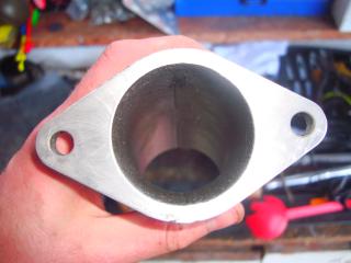

I'm going to go down the instant gasket route for the air intake pipe, you can see the remains of a plastic gasket that I removed when I cleaned it up. The pipe does not seal correctly although it has been flattened off on a steel bench with wet'n'dry. It still drips a little oil out of the bottom and I'm not getting my turbo boost. I still need to change the actual inlet manifold gasket as well but haven't yet as the one in the set I bought was a bit rubbish (it was motoquip).

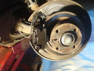

Just a quick update tonight. Cars behaving itself fairly well, engine mount still in one piece and doing quite a few miles lately fairly effortlessly. Got a nail through the ns rear tyre a few days ago, it was very windy so I didn't notice and drove about 1/4 of a mile on it so tyre dead. New one on order, why does that only happen when I have new tyres? Car needs a clean too.

I finally got fed up of the intake manifold dripping oil and smeared some instant gasket around the faces. It's stopped dripping but not improved the running of the engine so still needs further attention. I'm back on 4 matching tyres now as well which is nice. Very nearly due a service so I'm developing a bit of a list of things to do on the day which is constantly evolving. I'm going to check the tank pick up and the diesel pump banjo soon and replace the clutch cable, I'm prity sure the clutch pedal is going to meet the floor soon. Service won't be as major as last time although there are still quite a few jobs to get done, each one is getting a bit smaller and cheaper though so I'm happy for now.

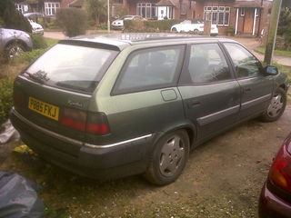

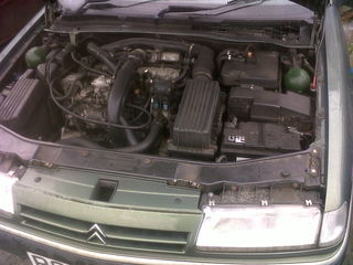

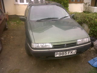

I've finally got around to getting a new radiator. It took me a bit of time as I found a spares or repair Xantia 1.9Td Vsx Estate with a new radiator and a knackered clutch when I started looking. I won the auction for it but had to go to Kent to collect it. I wasn't expecting much from the car as it looked a bit tatty but it's surprised me.
The first good thing about this car is that the engine was rebuilt 42,000 miles ago, the last owner is an aircraft engineer and I was convinced when I met him that he will have done a decent job. The next bit I like is the seats which are so much more comfortable than the leather ones in my car. It's an estate too which is better for me. When I took it out for a drive it felt more solid than mine, the engine idles correctly and the front end just feels better despite needing tracking and control arm bushes. It's hydractive is working properly as well, it's got the piggyback box to repair the diodes and having played with it my red car clearly needs the same. Theres loads to sort out on it though like the jammed sunroof, smashed os mirror, missing under tray, crumbling strut tops I'll actually be stealing the modified brain, summer tyres and the radiator from it today. I'm not sure where I'm going to go with this though as they both have bits the other wants and both need a couple of big jobs doing. I think I prefer the estate and not changing a diesel pump but that leaves me changing a clutch and learning a new cars little issues again.
The Ice Cream van has been delayed a bit due to rare good weather. We've got the new shaft ready to fit and are just waiting for some rain. Haven't forgotten though.
