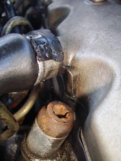

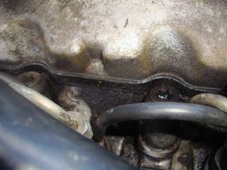

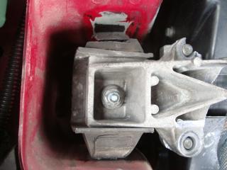

Not happy today, been on the road for less than 4 whole days and I'm parked up again. The stupid engine top mount has broken again, obviously some underlying reason for it but I don't know what it is and my cars knackered again. I'll be onto the scrap yard tomorrow, for a mount not to scrap the car.

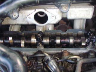

It started off as a productive day, I flushed the oil cooler and went for a spin, still overheating so Jims offered to help me put with a spare. I was feeling productive so decided to do the rocker gasket and the one on the air intake above the rocker cover.

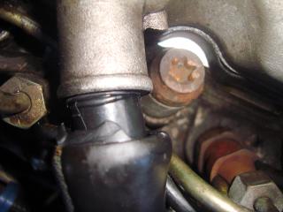

Result is that the rocker gasket is changed, the air intake one isn't in the kit (there was a similar one at 3/4 the size that I thought was it) and I've broken the return pipe/breather pipe from the rocker cover. Breather pipe has been bodged up with garden hose and insulation tape until I can get to the 306 to rob its one.
The rocker gasket (and that hose I broke) was hard and brittle, it snapped with a bit of flex so no wonder it wasn't doing the job. My biggest worry now is what state is the head gasket in? As far as I've delved into this car every piece of rubber and every gasket needs replacing, I've always wanted a pressure tester and may now buy one.

Elma, that's odd about the engine mount..
Is the underlying rubber cone it sits on OK? It's actually a rubber spring filled with oil and if it's punctured and all the oil has leaked away then the mount will be rigid to the inner wing. That might be a contributory factor so I'd not take a chance and replace that too...
The other suspect might be the lower mount is rotten and allowing the engine to rock excessively...
Have you got the two rubber dampers in place either side of the top mount and the heavy bracing bar across the top?

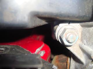

I'm not sure about the cone, the Xantia had the better of the two when I took the top brace from the 306. Everything else is present and correct. I'll get the top plate from the scrap yard tomorrow and order the lower bit soon as I can. It's broken in the exact same place as last time so the cause is likely to be the same. I thought it was the rear of that wedge missing in the 1st picture from last time, apparently not as it was replaced. Look at the gap in the 2nd picture (todays one) though, shouldn't that be in contact with the body?
I've just had a good look, the wedges are ok with about 1-2mm clearance from the body front and rear. The lower cone looks a bit old and it seems to not have much resistance to movement when the engine is revved gently. I think lower cone and new top bit again should do it.

That looks to be the right cone Elma....
I think that's all you need...

here is price and part No. for the breather hose you broke, you know the one that had turned into plastic

I've sorted 2/3 of it now, breather pipe went on easily enough. I took the engine mount apart and found that the new one has a greater height rubber cone by about an inch. The factor went on Citroen service to get the part number so I'm looking for the correct measurements now to see if I've currently got the wrong one. For now I have only fitted the replacement top metal bit until I'm sure I have the right one. The top bit fitted too tight, the mounting pegs seem splayed out a bit, I removed the studs and they are straight so I wonder if the base is bent. Its cambelt off to change so I'll get another top bit and the bottom bit in case it goes again and keep an eye on it.
My xantia may be a bit different to a 306 Malcolm, I nearly went down the route of making a tool for those grooves and holes in the cone. There's a 16mm but on the end of mine though, accessed through a window in the wheelarch. I had to put it back on though in case the new one needs to go back.

I've been silly, it is the right part. The old one has been squished by the weight of the engine. I can squish this one half an inch with my fingers. I guess I'll be fitting it in the morning.

Was the old one still squished when the engine load on it was relieved Elma? If so it's definitely not happy...
