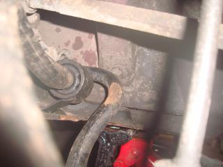

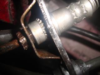

Hi all, does anyone know if these unions have the little pipe seal like the rear brakes?Image
I'm about to order my last last parts for the mot.
Posts: 52784
x 7241
Re: Elmas Xantia VSX
elma wrote:Hi all, does anyone know if these unions have the little pipe seal like the rear brakes?Image
They do Elma, they all use the same 3.5mm seal...

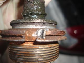

I did find an alarming problem with the engine today as well. See the pictures of what my coolant looks like.
It wasn't like this 48hrs ago and the engine started to smell different on the way to my parents this morning so I think it's very new. This coolant was very clean before today as I flushed the system when I changed the water pump within the last 2.5k or so. I shall put the 306 oil cooler onto the Xantia and flush the coolant to see if I'm in trouble or not. Has anyone ever seen the lithium grease like gunk I have in my coolant before? I've seen stuff like toothpaste stuff and pussy stuff in coolant but never grease like stuff. Also is it copper grease or thread lock to fit a lower balljoint with?

That gunk in the coolant is odd. It won't be the oil cooler as the gunk is too clean.. It looks like wax and may be from a rupture in ether the waxstat that controls cold idle or the thermostat as both contain a waxy substance...
Oil, if it was the oil cooler, would be black and horrible...

Jim thats the best news anyone could have given me, the thermostat has done 5k so probably it is the wax stat which makes me really happy. I don't think the 306 has the same one for its Lucas pump so I'll pull them both apart and examine. Do you think the rainbow colours are just from the wax maybe? They were the main indication of oil to me.

I reckon the wax, when it melts in hot coolant, will certainly be oily enough to make rainbows...
I'll be interested to know the outcome but I've seen cooling systems where the oil cooler has ruptured and it really is nasty in the extreme...
Imagine what the sea looks like after a bad crude oil spill and you get the idea...

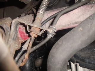

My Nightmare of a brake hose is also changed. It wouldn't come out with just the Bahco grips, I had to heat it.

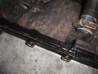

Heres my leaky sump.
