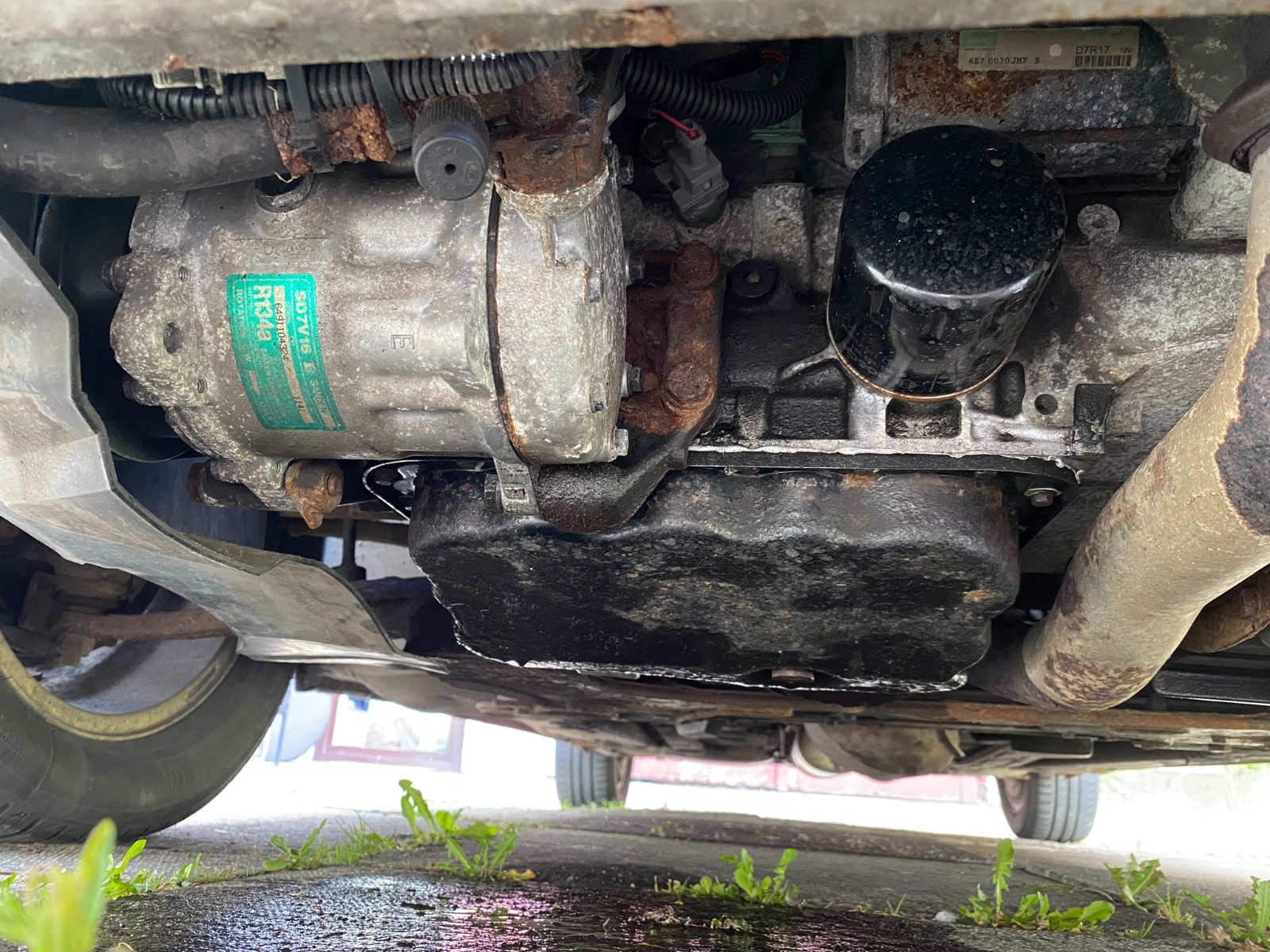

Still really struggling with the oil sump issue. :(
The local garage that I normally use are not interested in attempting a repair to the oil pan (probably worried about bounces) and after having another look online just to double check there are just none available anywhere even second hand.
If I remove the oil sump myself does anyone know somewhere I could send it for proper repair ? (grind, weld, repaint etc)
The car is at an age now now where if I can't get this sump pan repaired (and replacement doesn't seem an option) the car will be going off the road for good as the number of repairs and problems recently have been stacking up to the point where I don't have the time and resources to keep it going.
Every spring/summer I seem to have a long list of repairs that need doing for the MOT then the car hardly gets used and some new problem happens a few months later that puts it off the road for several months (due to lack of time and good weather to attack the problem) so it has hardly been used the last couple of years. :(

Type . "welding services in North Lanarkshire" into Google.. loads of welders come up.
Or call a local Welding Supplies company and ask them for some recommendations.
Or...take the sump (clean) to some local body shops and wave a £20 note in the air

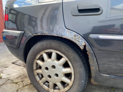

Rust.
Surprisingly the usual place where these rust inside the rear door shut area is NOT rusted, however the rear wheel arches are badly rusted with the rear right having a big hole and a piece that is ready to fall off. The left hand side has a lot of bubbling in the paint work. There's some bubbling on the front wheel arches as well.
Underneath the main body is not rusted due to the underseal, however the suspension chassis areas and suspension arms have a lot of surface rust as would be expected at 26 years old. As noted the brake caliper bolts are rusted such that I can't get the top ones out.

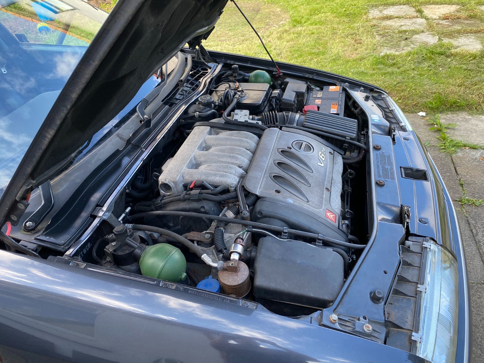

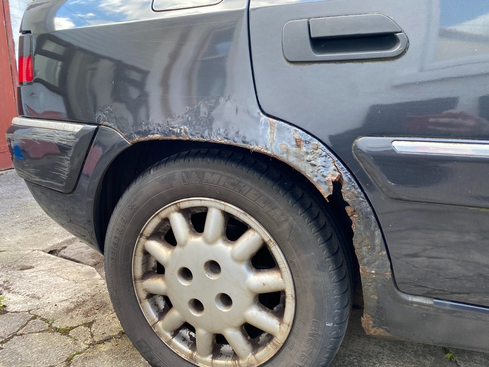

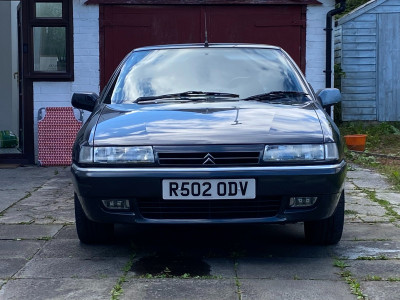

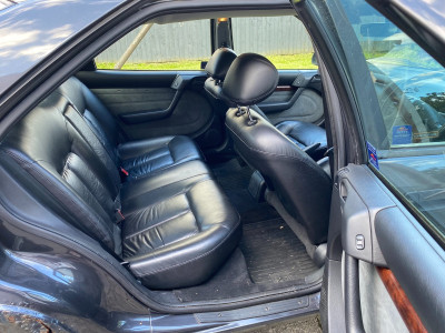

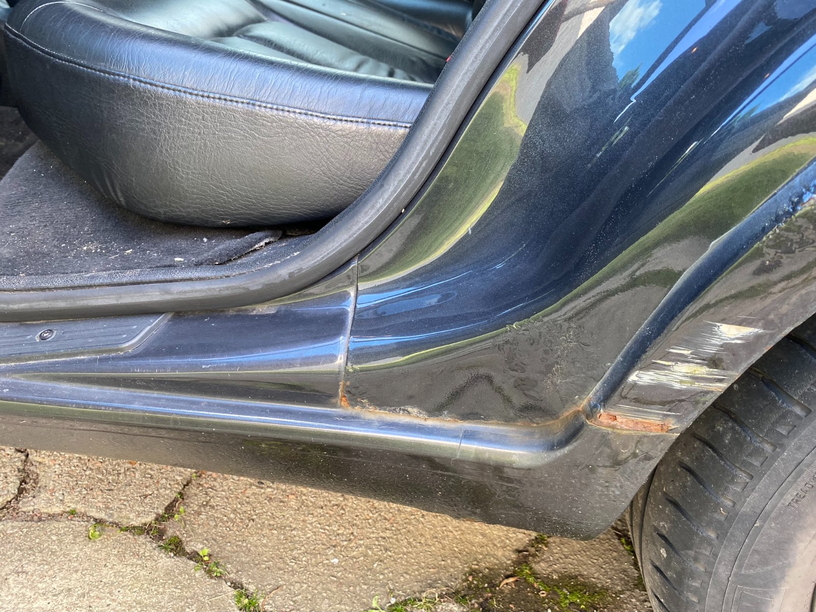

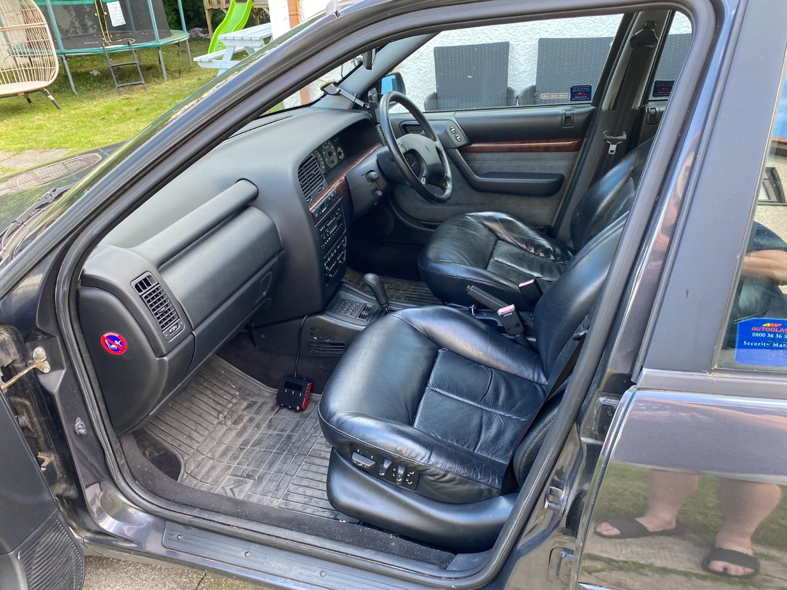

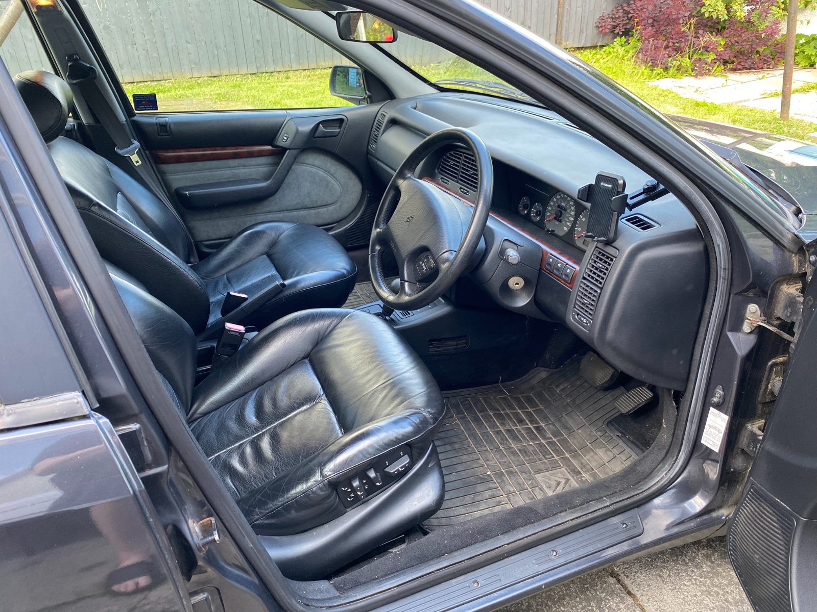

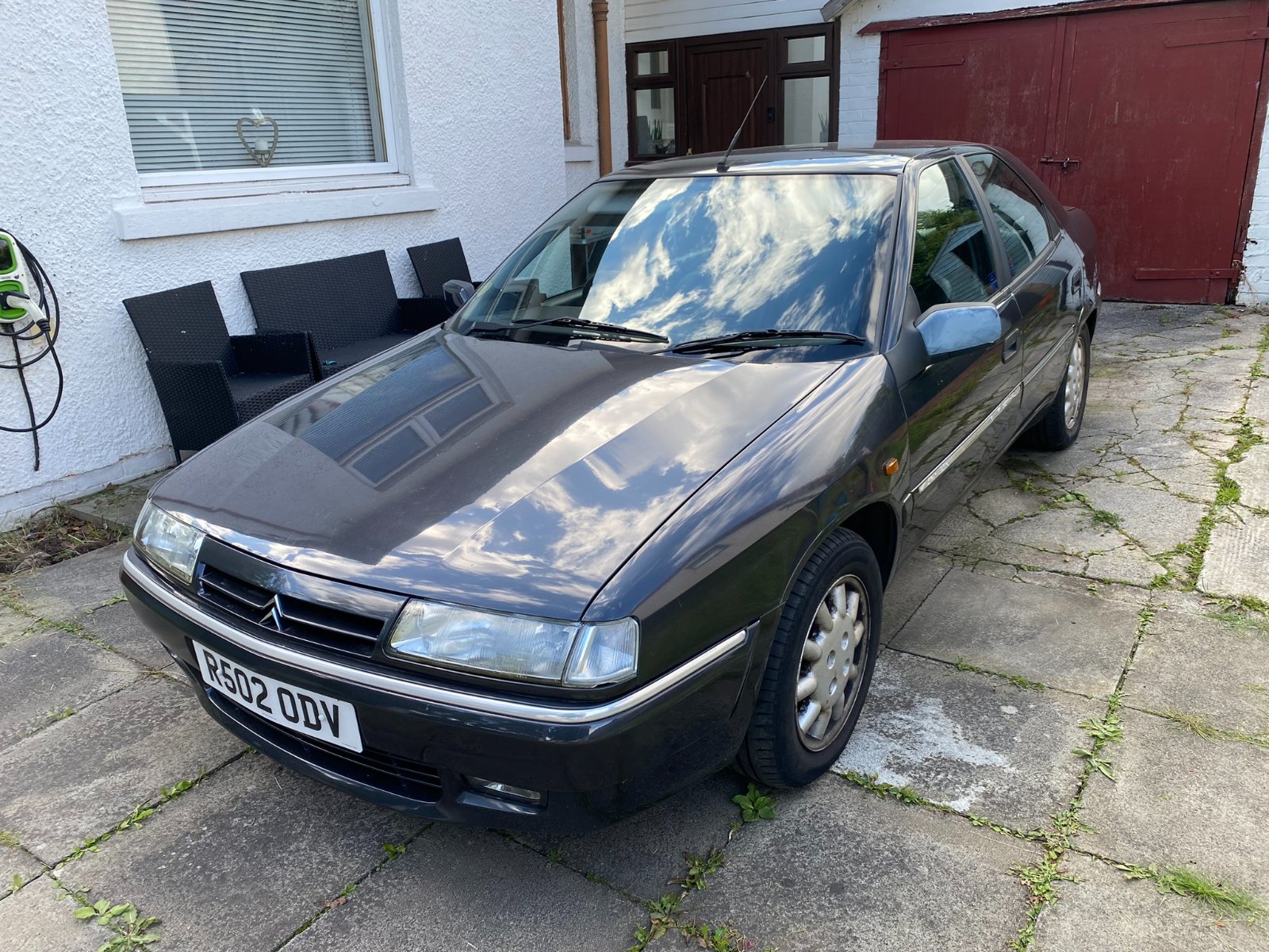

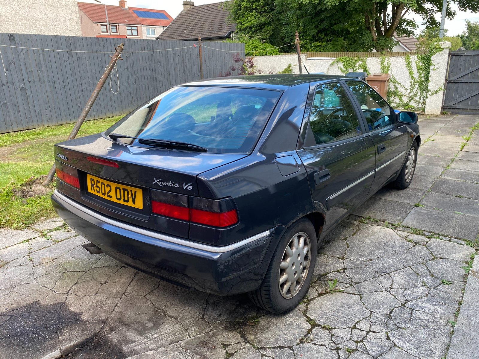

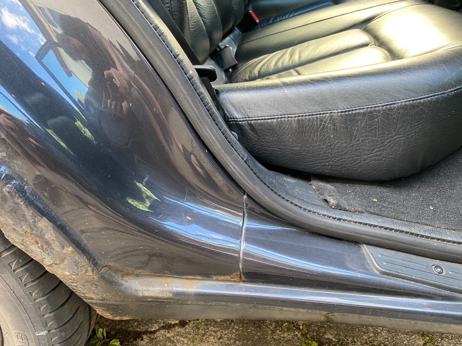

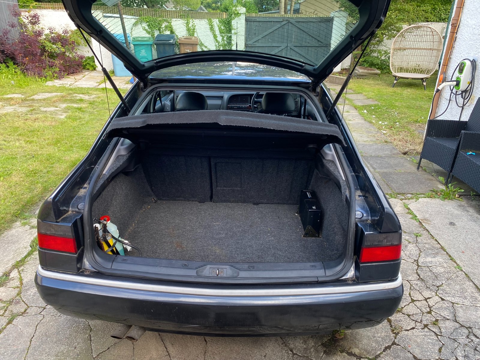

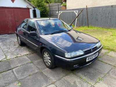

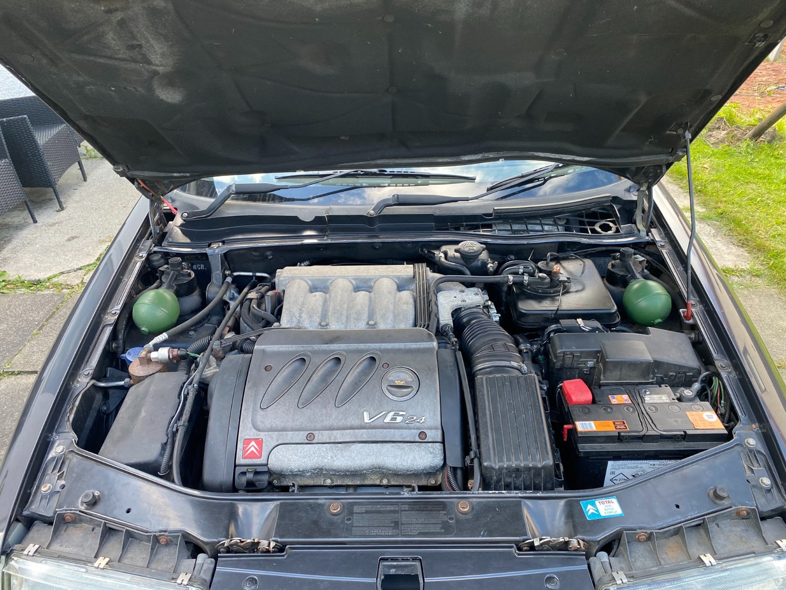

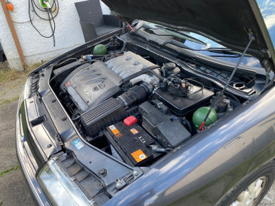

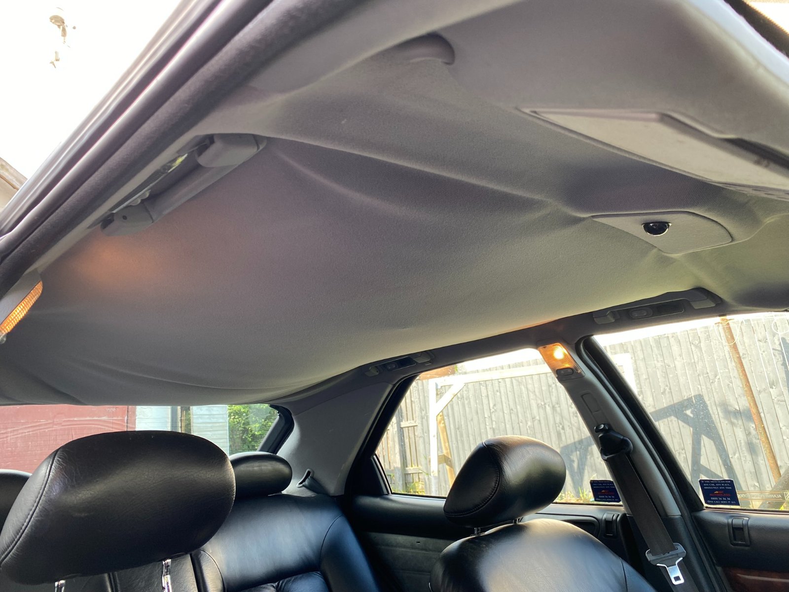

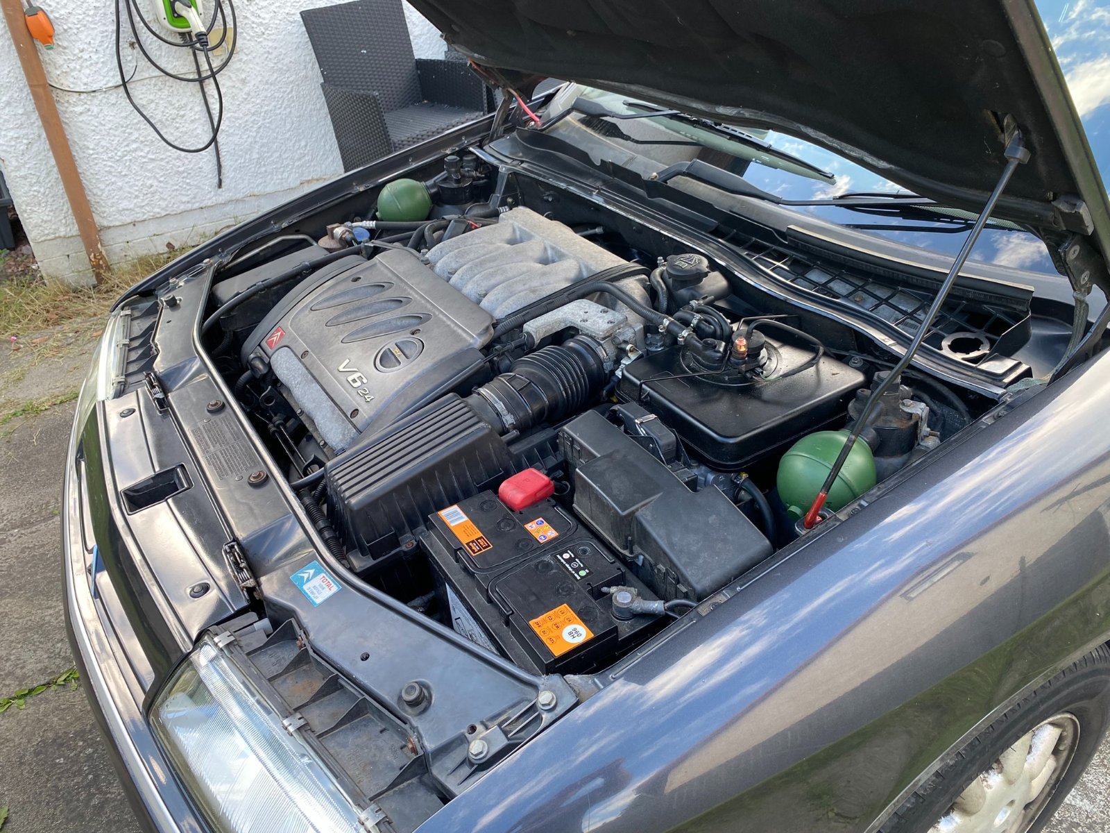

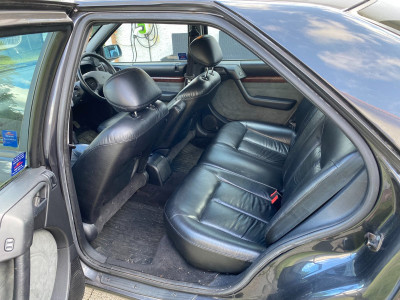

Photos as promised.
