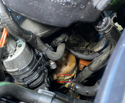

The second thing I found while I was warming the engine up is I noticed the cabin heater was not getting hot at all. With a sinking feeling I checked the expansion vessel and it was empty. It turned out that it needed well over a litre of coolant to top it back up again. I let it idle for a while until it could get hot enough to open the thermostat and bleed itself and the heater and radiator both started warming up as normal.
Now another month later I went out to check the car and the coolant was not visible again - despite the car not even being driven. It took around half a litre to top it up this time. I let the car run for a while until the coolant was maybe 60 degrees and I think I've found the culprit:
With the engine running and the coolant hot/pressurised there were two tiny streams of coolant squirting out the side of this "Bulb" connector along the seam indicated by the red box.
As soon as I cracked the expansion vessel cap it stopped leaking so it only seems to leak when hot and under significant pressure.
So what is this thing and is it unobtainium now ? How difficult is it to replace it ? With the coolant expansion vessel removed is there sufficient access to replace it just through the top or does it take some significant disassembly like removing the throttle body ?
Anyone know where I could get one of these ?
I'm also concerned that if the car has been driven 10 miles or so with the coolant level so low that the radiator and heater were no longer working (thinking back the heater was NOT working on the day it was being driven where it keep seemingly dropping to 4 cylinders!) that there could be damage to head gaskets etc...

I think that's what stickyfingers has trouble with
a 'swirl pot' I think he called it ....I'm sure he had one made out of alloy if it's the same part
Send him a message and check ...

I think that the plastic degassing tanks (1307HJ) are being remanufactured now, but a quick search does not find them. I have a spare used one (in good condition) that you can have, but I can't get it to you until the beginning of May, as it is in France and I am in New Zealand.
For your fault codes, I would try cleaning all of the wiring connectors that you can find in the engine bay and ECU box.
