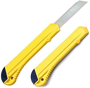

Any hardware shop should have something like:
I have on different occasions used one of these (fully extended) or a paring knife.

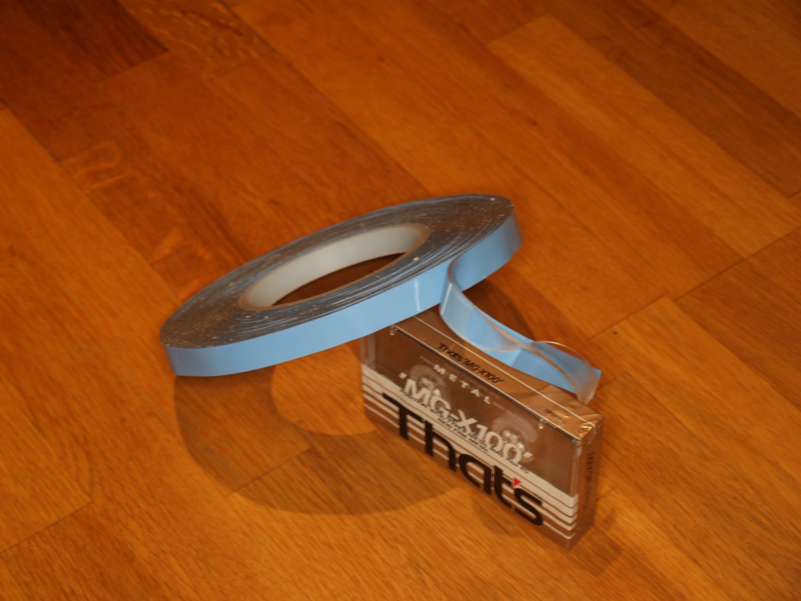

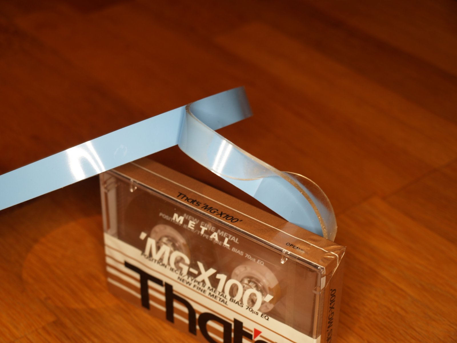

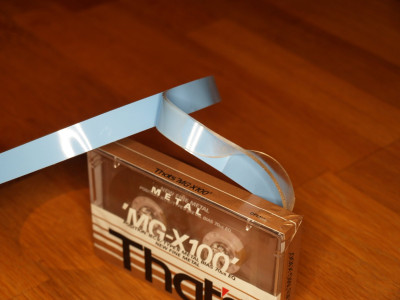

Is this the kind of tape that you mean?
This is used for fixing the glazing units in PVCu doors. On the outside at least. A cheaper black sponge tape is used on the inside.
Surprisingly strong.

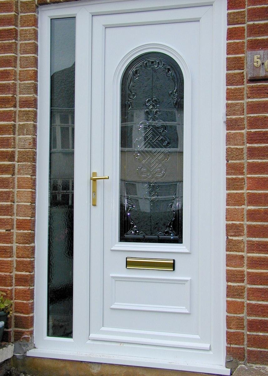

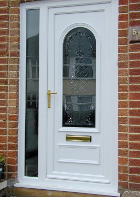

This kind of door:

It looks similar to the tape I used, but the stuff I used had a "thickness to it..........it was used in the same way for windscreens.
The guy said do not use it as masking tape/on the outside as it will pull paint off.

That tape is 1.6 mm. thick.
