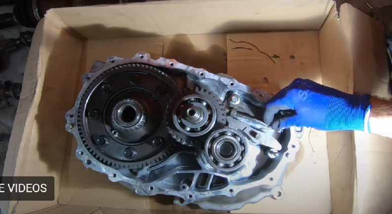

Looking at what's in the box, as far as "gearboxes" go, could anything be simpler? The other thing about "whats in the box" is that it is parcelable, and sendoffable to a gearbox specialist.
With a gearbox in a box, and the right tools for pulling bearings off shafts etc, if indeed the problem is a bearing, how long would a gearbox specialist take to replace a bearing or two, and how different are Nissan leaf gearbox bearings from any other gearbox bearings. The answer to that question is I have no idea or indeed whether getting off the shelf bearings from the bearing makers, or Nissan to that spec is indeed a possibility.

For the inquisitive here is a complete strip down of the drivetrain of the Leaf. A lot of what is shown in the video probably isn’t required to get the motor and gearbox off the bottom though…

I've started the vid at the section where he recorded the sound. In comments on the second vid one person said NISSAN had authorised replacement of the driveshafts and the reduction gear.
The second vid (just talking) where this comment was made. 2 years ago and "warranty work" I presume.
Jim Gassor responding
Just got a call from the dealer, apparently they have also replaced the reduction gear and 'both' drive shafts, which Nissan authorized. They state this has resolved the problem and that I can collect the car today. From my understanding, Nissan shipped them both the reduction gear and drive shafts at the same time and both items were replaced, which does not help to answer if the problem was in the reduction gear or the drive shafts. At least we know it was not in the traction motor. I will reply again after I pick the Leaf up this afternoon to confirm the problem is resolved for me.
Just picked up my Leaf from the dealer and drove home. Problem is definitely resolved. Replacement of 'reduction gear' and 'drive shafts' ultimately solved the problem. They had also been advised to comply with technical bulletin NTB-12-055F, which essentially instructs them to grease the axle hubs but they followed up with Nissan to state that this NTB did not resolve the problem.
