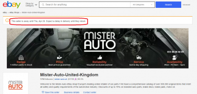

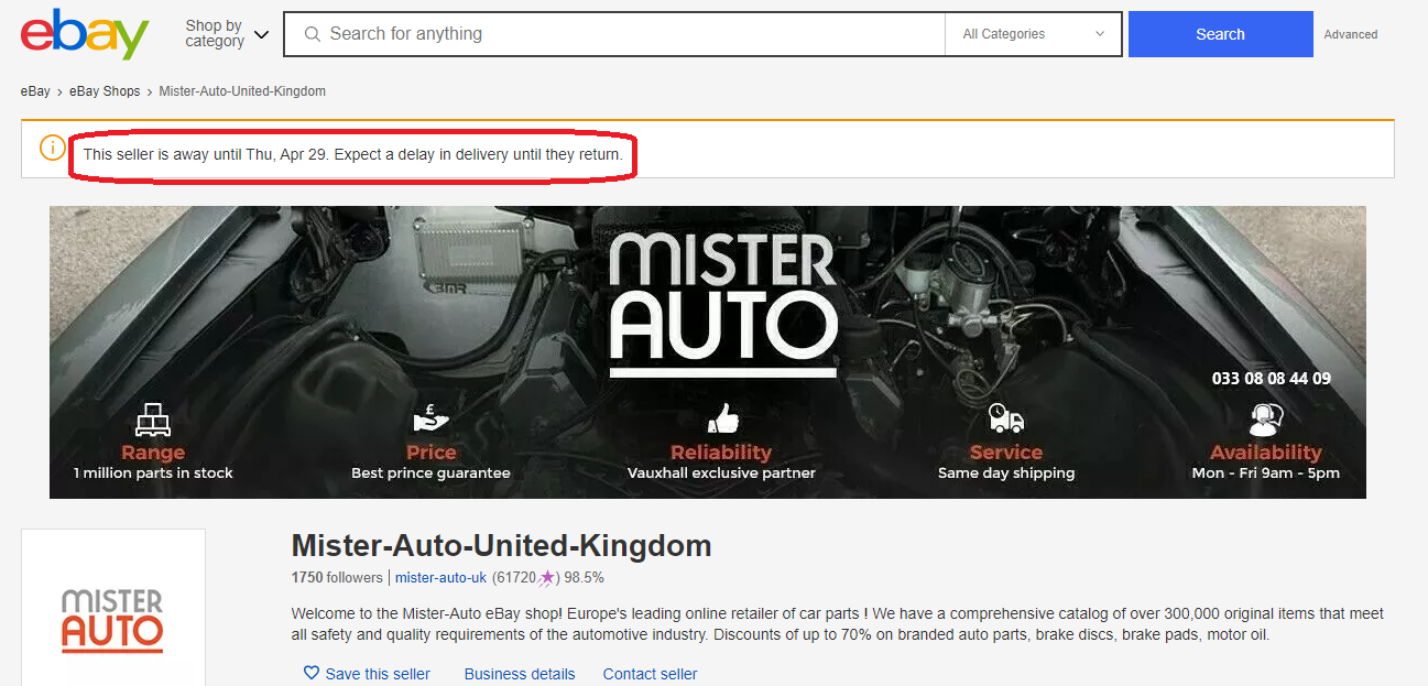

I fear you're right Chris. I voted remain at the time and when the final countdown started last year I ordered a few things from the EU that would be more difficult and expensive to obtain post Brexit, including some hard to source in the UK speaker drivers from Germany!
If there is too much paperwork to be done and fees there will be many companies who will just throw up their hands and say "too hard", just like there are still many websites in the US which years later still block access to the EU (and UK!) over GDPR because they can't be arsed rewriting their sites to conform with GDPR regulations. (And I don't really blame them to be honest)
I think mister-auto will be back though as their ebay page is on hold but says they will be back on April 27th. So we'll see. In the meantime they've lost about £130 worth of total sales from me as they had all the different items I needed in one place.
