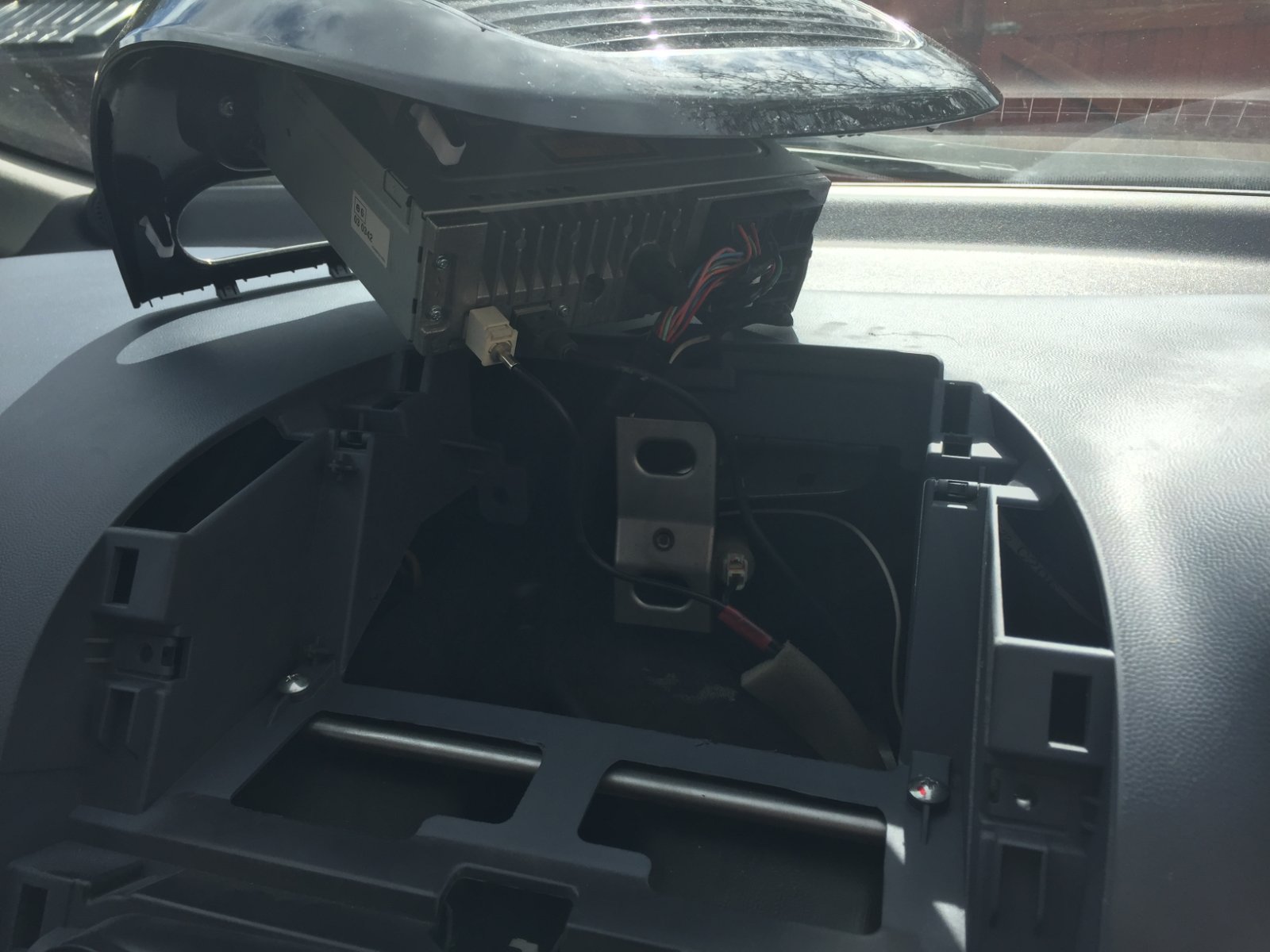

After we got home and I was contemplating how to fix the vent another problem presented itself - the RF fob for locking and unlocking stopped working! Or at least so it seemed at first. I know from enquires made when I first bought the car that replacement RF fobs are £200 from Peugeot. Damn!
By accident I discovered it was actually still working - but only at an extremely short range. Normal range is about 50 metres however I noticed that it still worked if it was held less than 20cm from the front door windows! I assumed the problem might be a broken antenna so I took the fob apart and checked for any dry joints - nothing to be seen, and it is extremely well made compared to the Xantia fob, complete with rubber gaskets to keep the circuitry water tight and even the battery cover had a rubber gasket. I tried another battery but no change, and I don't have a 433.9Mhz receiver to try to pick up the signal it transmits.
I was a bit gutted by this and realised that the problem could be in the receiver in the car... so I decided to tackle the air vent in the meantime. I thought that lifting the radio unit out might give access to the rear of the air vents so that I could push the cross bar back onto the joints on the flaps, but no such luck:
However after lifting the radio out I discovered the Fob was working at normal range again! Hmm....
so I can only assume I disturbed the wiring for the antenna for the central locking receiver and that fixed it - and perhaps it even shares the radio antenna with the radio... After putting the radio back in the Fob is still working normally.
Perhaps the wiring behind the dashboard was disturbed when the whole dashboard was out for the airbag recall...

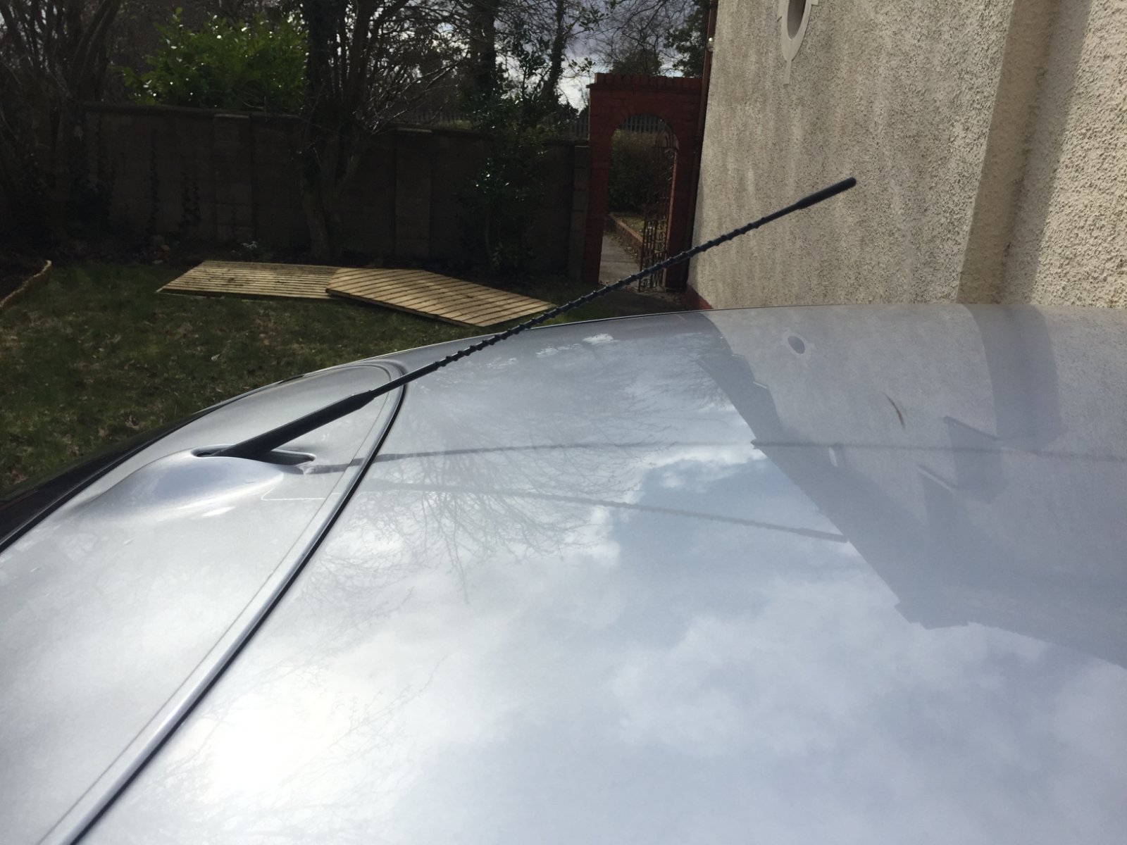

Another odd problem I've had with the Ion lately is that at about 70mph or above (which I don't often do) I would start to hear a loud tapping from outside the car. I eventually realised the radio antenna was vibrating up and down so much in the wind that it was hitting the roof! If you look closely you can see where the tip of the antenna has made a black mark on the roof:
I was pondering what to do about this until I realised that the antenna could be tilted up a bit more vertical than shown in the picture. DOH! So obvious...
But I'm still puzzled how the wind could bend it down so far that it was hitting on the roof from the angle shown in the picture...

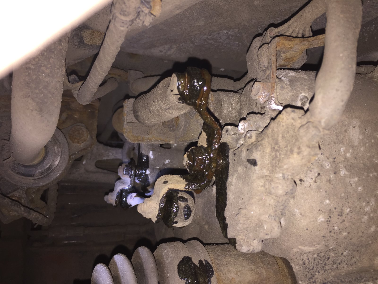

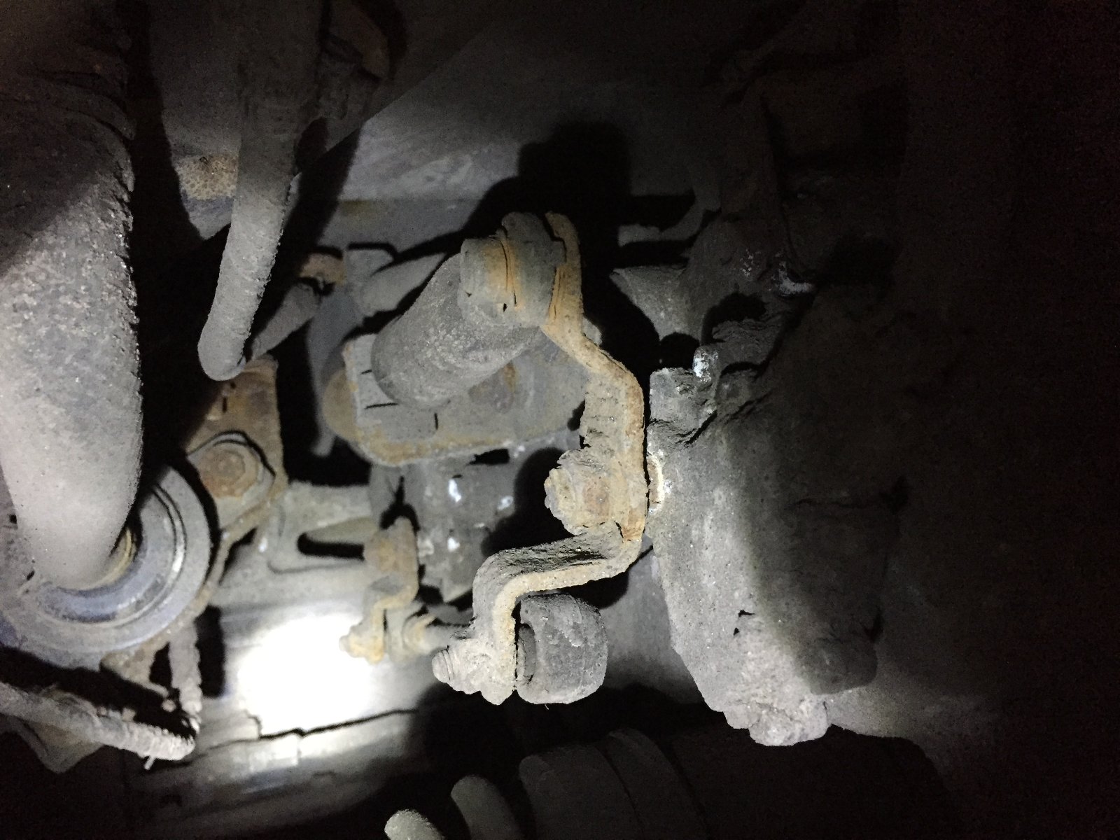

Mandrake wrote: 29 Jan 2018, 22:09 Well it was playing up again today and as it wasn't raining tonight I thought I better do something about it, even in the dark!
When I left work the lever was quite stiff and "springy" at the ends of travel and I found I couldn't push it fully into park - and it triggered a fault immediately. It also felt like it was trying to spring out of drive. So I backed it up onto the ramps tonight and saw this:
The switches themselves can barely be made out from the dirt and corrosion.The two switches are quite a long way apart (about 6 inches) with a long link rod with a ball joint at each end joining them. I just gave all the pivot points and ball joints a thorough douse of standard cheapy halfords spray grease I had on hand:
After greasing it like this and giving it a good working back and forth the gear lever feels like new again - it travels easily right to the ends with no springiness and there is a nice satisfying engagement when you go between drive and neutral instead of it feeling like its trying to jump out of drive. So far, I can't reproduce the problem with it reporting an error in the park position.
The bowden cable itself is completely enclosed with a large rubber concertina boot (at the top) so I wasn't able to get any grease into that, but it doesn't look like the cable is to blame anyway.
From what I can see the issue is the ball joints seizing up - probably due to dirt and moisture building up in the cups, as they look somewhat exposed to the accumulation of dirt and moisture! Although I sprayed grease on the shafts themselves, I'm not convinced that that actually did anything. It's possible corrosion at the top pivot point where the cable attaches to the lever arm was also a potential culprit. I greased all the pivoting points just to be safe.
Touch wood this has fixed the problemand it looks like due to the silly exposed design of these levers and ball joints a bit of spray grease on the joints should be an annual maintenance activity. With the car backed up onto ramps it only took a few minutes, I didn't even have to remove a wheel!
I'm not going to try to adjust the switch position - with all the build up of aluminium corrosion and dirt around the switch I'd probably have to remove it completely and scrape it clean before I could rotate the switch body, and I don't really want to do that!

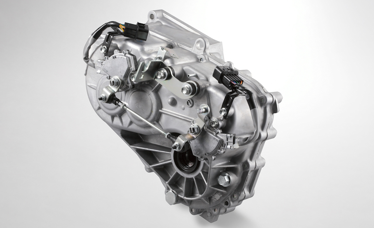

Came across a picture of what the gearbox and the two switches look like on a nice new never used gearbox so thought I would post them! (Bowden cable not shown fitted)
Rather tiny gearbox isn't it!
