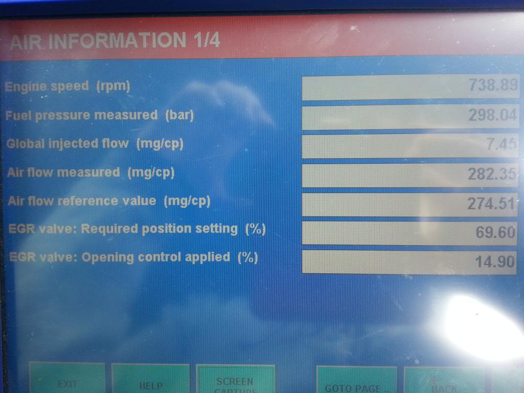

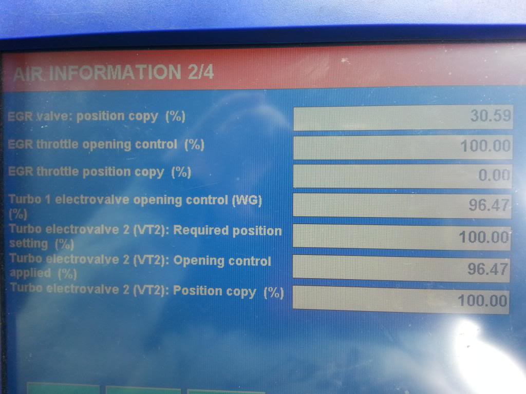

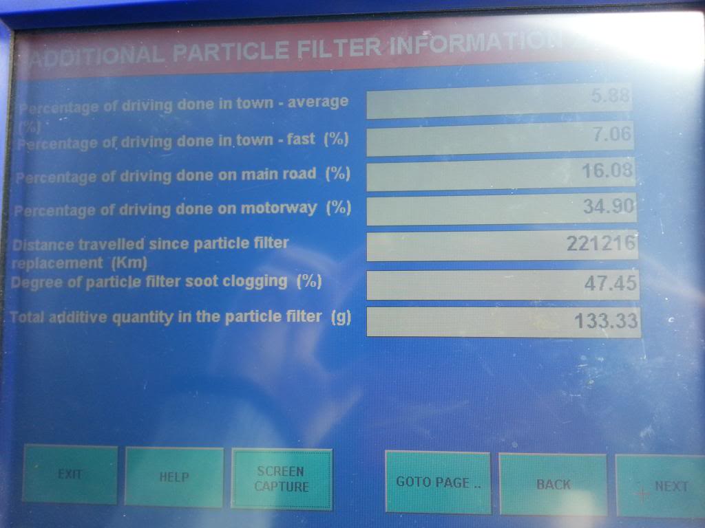

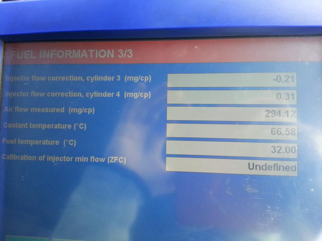

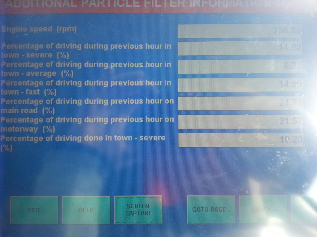

I borrowed a diagnostic machine and had a play with my "new" (to me) C5 today. I was just curious to see what was in there, what was available to change, how my values looked, and what faults may be stored if any.
Some screenshots are below for anyone interested.

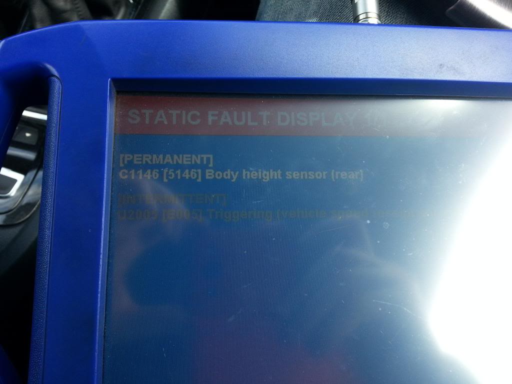

The only significant logged faults under the 'engine' screen were to do with the brake sensor (possibly because the other day I used the accelerator while also lightly pressing the brake - oops!). None of these faults caused a dash warning to show up or any other negative effects.
I'm not sure how to interpret "EGR opening control applied". Should this match the value for "EGR Required opening position"?
There was a fault for the rear body height sensor which I cleared. The readings show the height sensor as working okay.
Specifically I was looking for any hints related to the vehicle's performance. It's a bit lethargic unless you really keep your foot down. However the readings for air flow sensor and turbo etc seemed "normal" to my untrained eye and there were no recorded obvious faults.

Oh one more questions - would these fault codes (e.g. the rear height sensor) also have shown up on a generic/ebay OBD fault reader?
Posts: 14308
x 3306
Re: I put my '09 C5 onto a diagnostic machine
Doubtful. Although car manufacturers 'agreed' to standardise the diagnostics communications, they didn't all do so. Anyway, the Lexia can tell you so much more than a simple generic reader.

Hell Razor5543 wrote:Doubtful. Although car manufacturers 'agreed' to standardise the diagnostics communications, they didn't all do so. Anyway, the Lexia can tell you so much more than a simple generic reader.
Indeed and I do really want a Lexia but can't justify it when I have access to this diagnostic device. I hope this one (Autologic) does everything a Lexia does albeit at greater cost, since I spent an hour looking through every menu - there were hundreds covering everything from the Alarm's sensitivity to the stereo settings and depressurizing the hydractive. I can't think of anything that was missing - but then I've never used a Lexia :wink: .
Wishful thinking for a generic OBD reader to show those codes I guess.
I believe that was only for engine management & emissions related diagnostics so other systems like suspension, body control modules & autoboxes don't need to be standardised.
