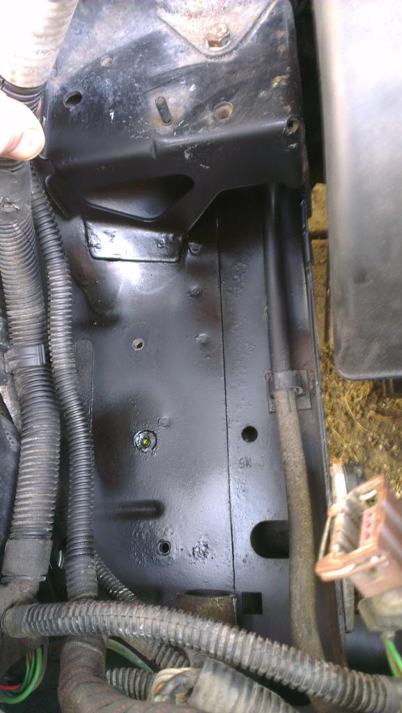

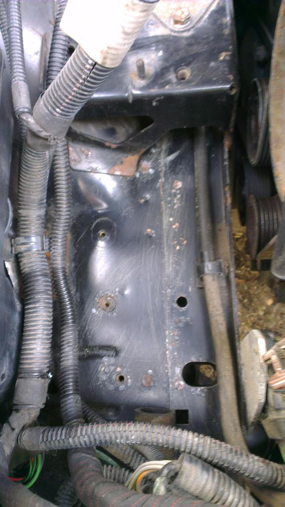

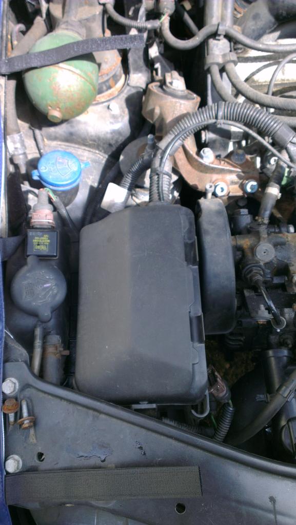

While the ECU box was out, a quick wire brush down on some small areas of surface corrosion underneath it.
Rust treat
Spray with Dinitrol (Love the fact it's a non-metallic black car lol)
Refitted. Exciting, huh? :lol:

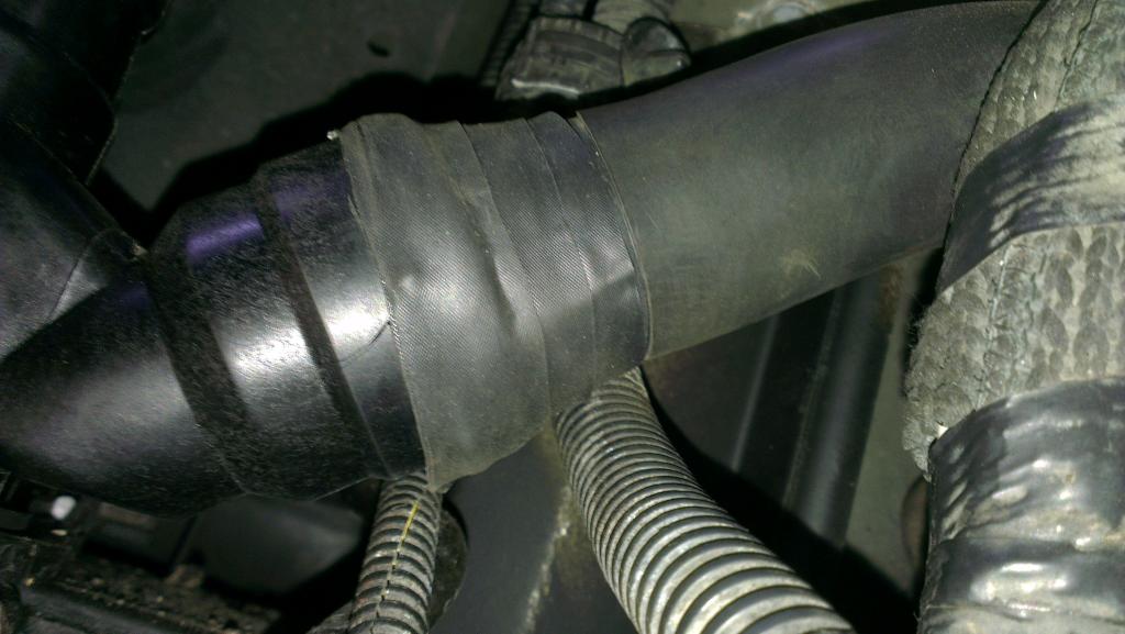

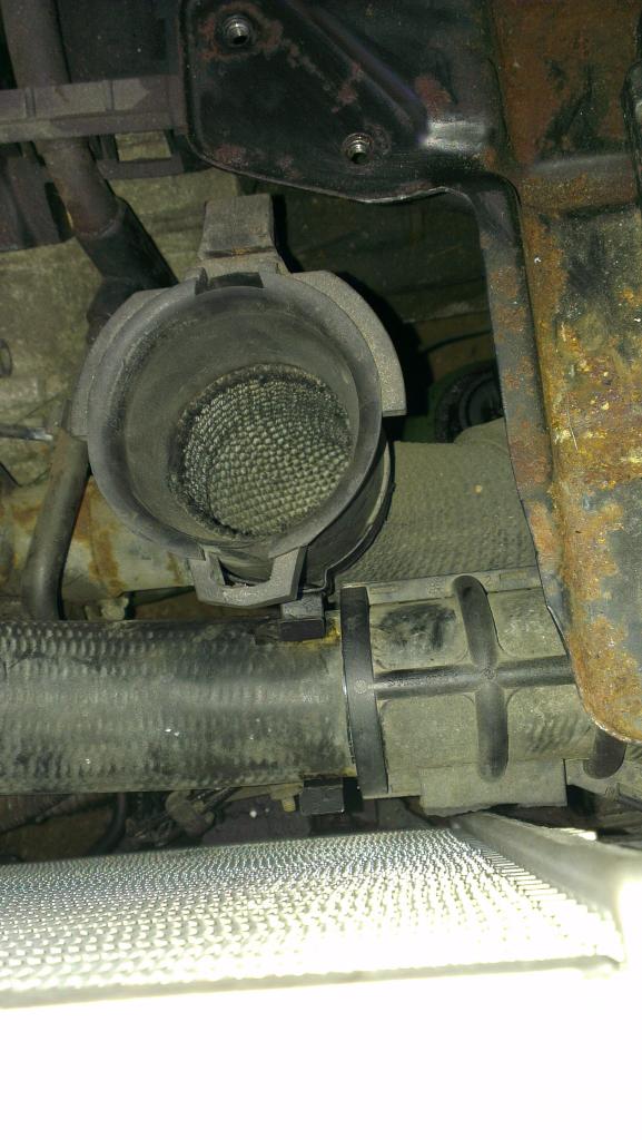

Trying to stop the bottom bayonet connector corroding again so I can get it apart in future, wrapped it amalgamating tape to protect it from salt spray.

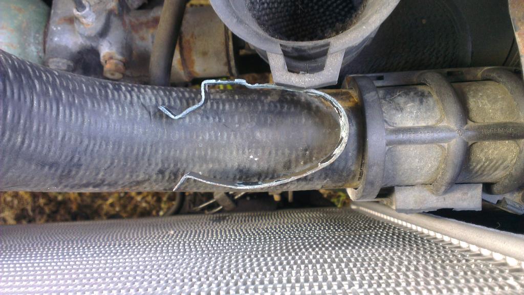

De-rusted air intake pipe bracket
Also correctly re-shaped so the inlet hose nearest the rad isn't squashed any more

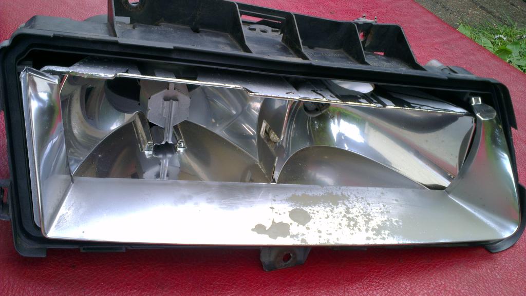

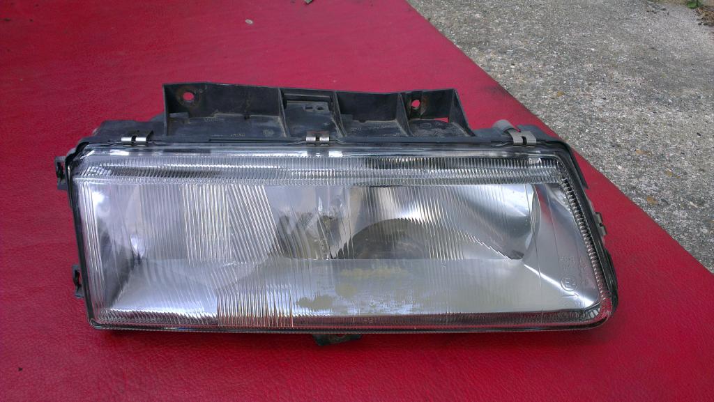

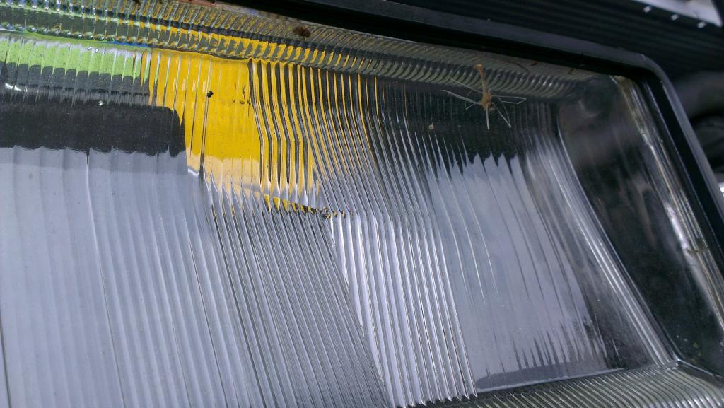

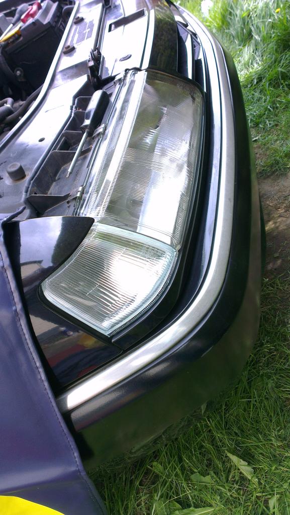

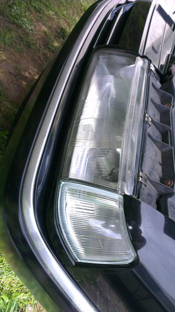

Front headlight had suffered from a bit of water ingress (turned out someone had had it apart before and not re-assembled correctly, squashing the seal) so took it apart in the hope it might just be deposits that would clean off with meths
Nope :( But did at least get the glass nice and sparkly and it won't leak any more :lol:
The other side had always had this little sod in it, so it came apart too while I had the opportunity.
Back together and treated to a new set of indicator lenses because the originals were discoloured and covered in tiny surface cracks. They're pattern parts so the fit isn't as good, but bargain at £9 each :D

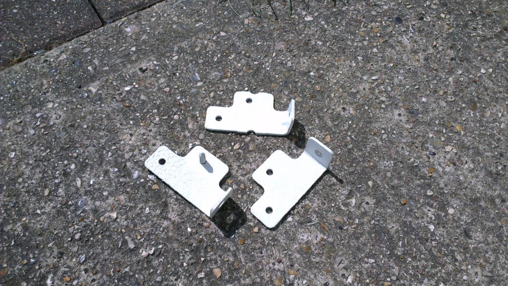

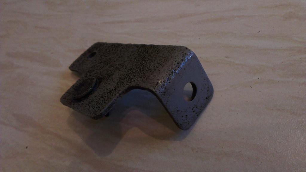

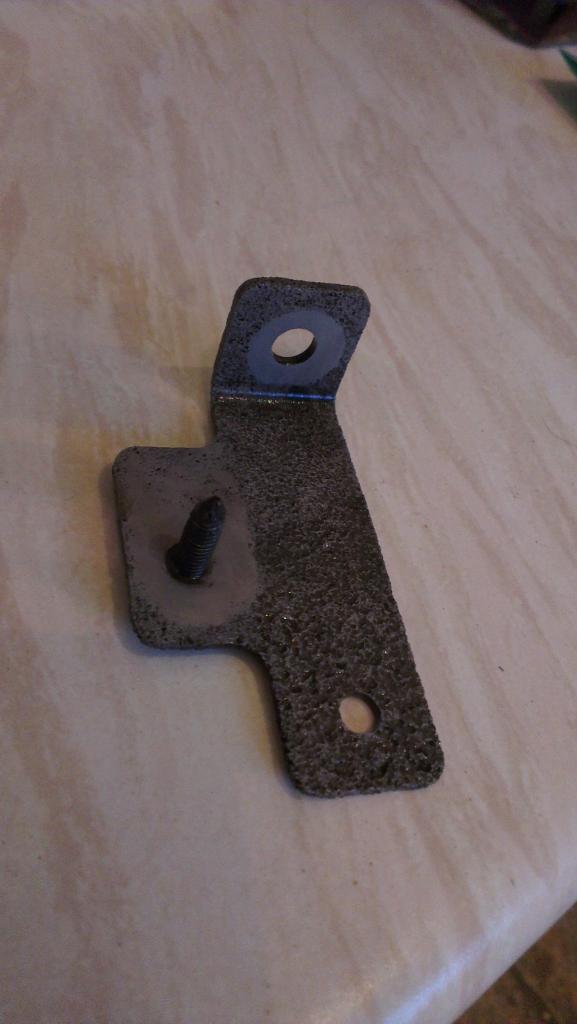

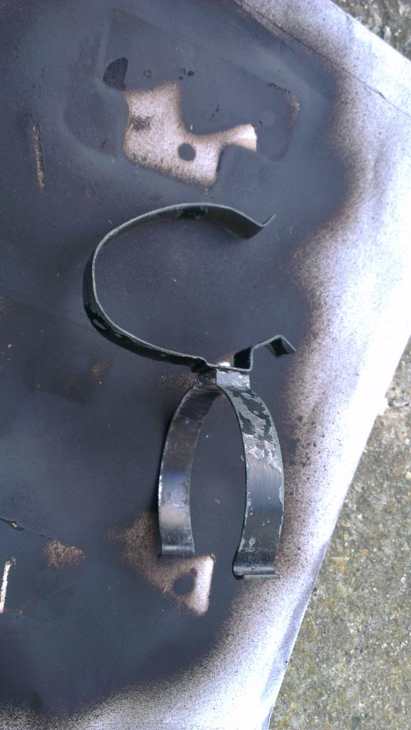

These brackets from under the rad carry the bottom hydraulic pipe and large wiring loom. They were well rusty, this is after scraping and wire brushing. Stuck them in de-rusting solution intending them to only be there for a couple of days, forgot about them and then remembered a week later...
Dark spots are massive pitting, not rust. Couple of coats of primer and Porka Alpine White (just because I had a load left over and what else am I going to use it for?)
The lary colour doesn't matter because it'll be covered in a coat of black Dinitrol. Refitted with all stainless bolts, 2 of which I had a massive fight with because of crap access (2 HOURS FOR 2 BOLTS! :evil: :evil: ) Mental note in future, if you remove brackets after the rad has been removed, ffs refit them before refitting the rad (and everything else) :roll:

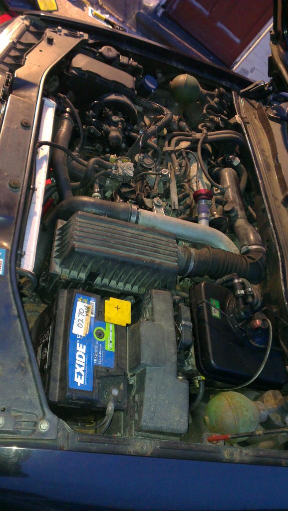

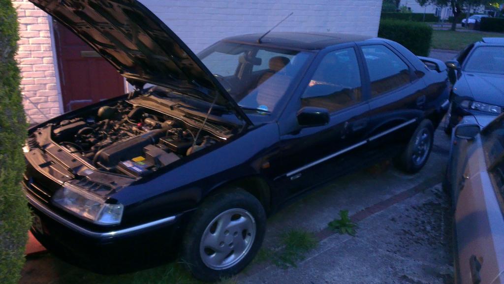

Front end finally all back together,
And back on it's wheels
(hollow victory though, because as soon as I lowered the suspension again, it was back on blocks - still got some more wire brushing and undersealing I want to do before I move on to adjusting the suspension :lol: )
