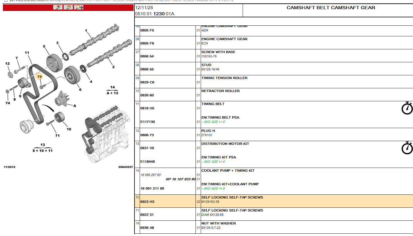

Re: Citroen C4 - Oil leak
You can get the part number from: http://service.citroen.com/" onclick="window.open(this.href);return false;c4newbie wrote:
Probably better solution will be to make new screw or order original one but i don't know part number.
For these screws:
It seems the part numbers are:
Self locking self tap screws: 6923 H3
Screw with base: 0806 54
