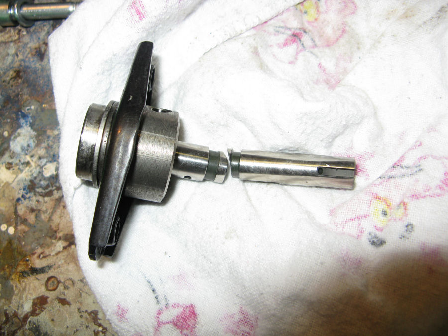

Re: Replacement of housing-seal of Bosch VE Dieselpump
Hello Forum,
Bad news I am afraid: I removed the Distribution Head of the pump. Something I hoped to avoid. But since I removed the seal on the Distribution Head, I instinctively thought that maybe I could find some broken springs or something in there, which would also explain the regular light sound I heard when moving the pump pulley around, via the crankshaft bolt.
I made a provisional stand on my workbench to have the Distribution Head facing up and removed the mounting plates and finally gradually lifted the Distribution Head. Which is pushed outwards by the springs.
Not knowing exactly how everything is supposed to look like, although there are photos of this procedure available (http://gnarlodious.com/vanagon/bosch_pump/-Rebuild and http://www.eastment.net/boschpump8.htm) in real life it still looks different, especially the size and feel of things. So at first I put everything aside that came out. After inspection however I noticed that there was something wrong with the Distribution Shaft : It been broken.....
The picture below I took of this.
So, I had a dark moment after that discovery. I can only imagine that it has been broken the moment I put in the new seal. Although I only did slightly release the Distribution Head, still it went wrong somewhere.
The fit of the Shaft is immensely precise, there is virtually no play in between the shaft and the hole in the Distribution Head. One should really take care and revolve each screw crosswise and halve a turn at the time. I did this to my belief very slowly and gently, but I suppose the truth of the matter is that I did not do that well enough.
But now the question is, what is the next best step. The Distribution Shaft should be replaced, but is that a part that is terribly expensive or not? Is it maybe better to find a second hand pump. Considering a Xantia Diesel can be bought for 1000 Euros, with a pump in it, means that I am not willing to spend hundreds of Euros on it.
Any thoughts on this on the French Car Forum?
