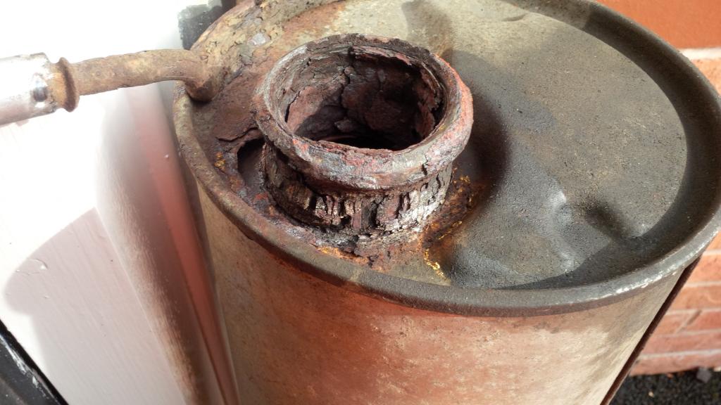

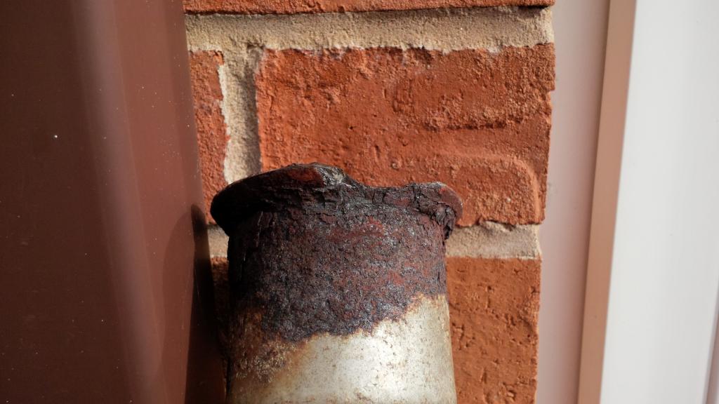

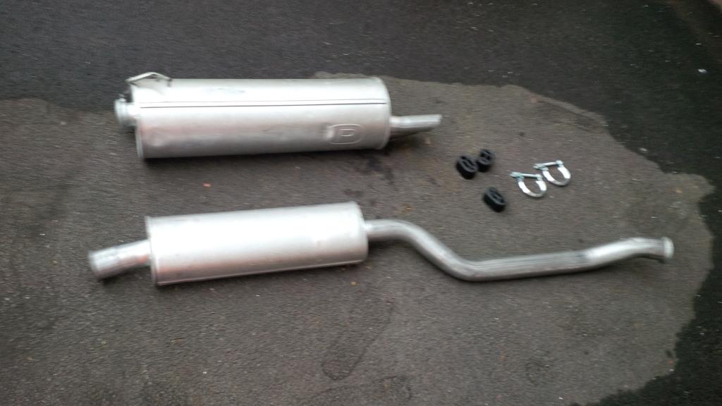

Well, not quite as productive as I would have liked, but still something's achieved, the old exhaust has been replaced by a shiny new one..
I had a good look at the old one and it's no wonder it was 'grumbling' shaking the back box sounded like you were shaking maraca's
I also noticed that the centre pipe was missing a chunk from the flange where it connect's to the back box
As was inevitable, the clamps between the two flanges were to small for the pipe, so I ended up going and buying a couple

I can't see the problem Steve. Years of life left in the old system. I mean, it's not holed is it?
Did you buy a couple of the Polish ones? Good value just to keep as a spare for later..
Be interesting to see how long the Polish ones last compared to OEM.

Steve. I was joking!! Too early in the morning I guess
The old one is 100% scrap...

Did the polish one include the cat as well?
Take it down the local metal recycling centre Steve and get some £ back
The only way I can see that polish one lasting as long as the original Jim is by sealing the outside with a heat proof lacquer and making sure the exhaust gets very hot every month or two to ensure no nasty acidic moisture sits in it for long

Actually I could do, didn't think of thatKP wrote:Did the polish one include the cat as well?
Centre pipe and back box, Will, as for getting hot. Well, there's no issue with that, it's my daily driverKP wrote:The only way I can see that polish one lasting as long as the original Jim is by sealing the outside with a heat proof lacquer and making sure the exhaust gets very hot every month or two to ensure no nasty acidic moisture sits in it for long

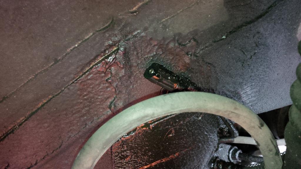

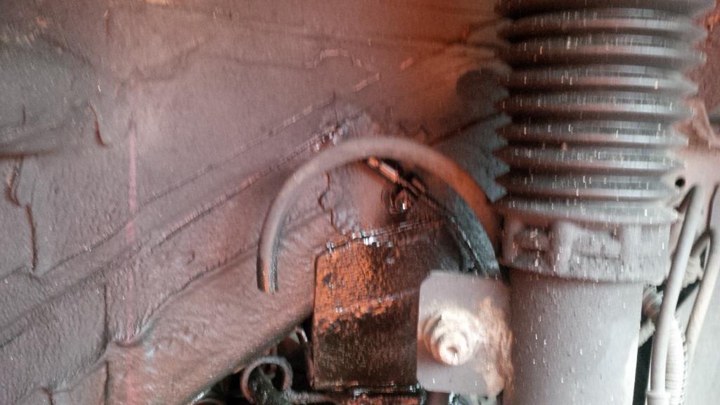

I managed to resolve the LHM leak yesterday, it turned out to be a return pipe in the Drivers side wheel arch, the rubber pipe had snapped off
so that was an easy fix. bleeding the system was a 'tad' harder as the only access you have to the bleed screw is from underneath, which of course you can't see
so, slowly getting through things, but I'm coming to a stop, shortly, otherwise Paul will have nothing to do........

Those leakage returns failing are a very common problem now Steve. One on a F fellow WFA'er's car and one nearly on my Activa..
Time to get more in stock methinks...

One on my c5 went as well and the clips are a bugger to get back on even with the right tool
