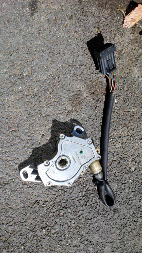

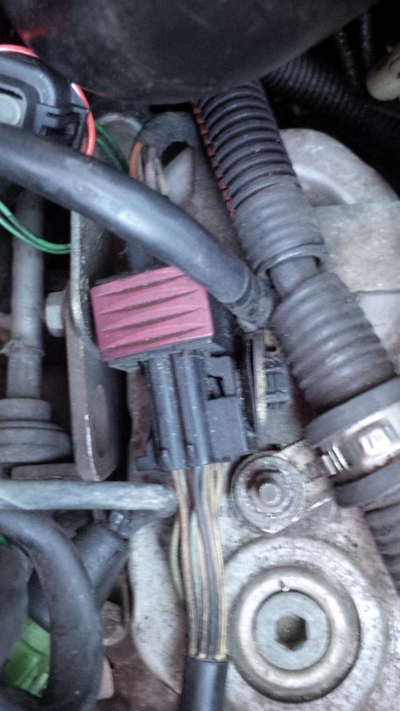

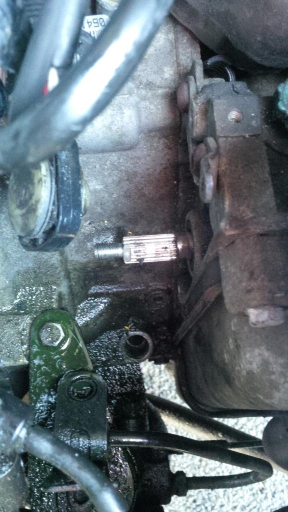

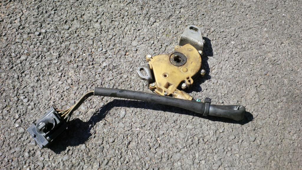

First and foremost a HUGE thanks again to Jim for posting me the switch...
Guys you were right, it wasn't to bad to do.
Bog standard start, air filter and battery off so I could see the little devil in situ
next trace the cable back to the joint, located under a pile of other stuff, you need a lat blade screwdriver to just lift the brown connector lock, before it will come apart, oh and the wire comes out from the top of the plug, because the plug itself has a plastic push clip holding it to a bracket.
There's 2 x 10mm bolts, one at the top and one at the bottom, which you (surprisingly
) can't see, the only way to get at the bottom one was a small socket, I tried everything else including a swivel ring key, There's also a 13mm Nylon tight nut which holds the cable to the switch, so I started with the top 10mm, then 13mm and finally bottom 10mm. There are also a couple of small LHM return pipes that I kept pulling off so beware of those, they just push back on. TIP When you have the air filter off, put something over the air intake pipe, I dropped a socket down there, which took me 10 mins of cursing and fiddling with a magnet before I got it out..
This one shows the spindle the switch sit's on, after the old one was removed, this is the old switch
and the new one supplied by the "Oracle" AKA Sir Jim
I took her out for a quick spin after finishing and all appears good, the real test will be tomorrow as I take her over to Runcorn in the morning.

What's that splash of LHM in the last photo on the pressure regulator bracket? It's not the in the first photo
Honestly, brilliant
- (Donor 2018)
- Posts: 2593
- Joined: 21 Aug 2009, 11:58
- x 43
Re: V6 Xantia......... the beginning of another adventure
It's from where I pulled a return pipe off Jim, cleaned up before being put back together
