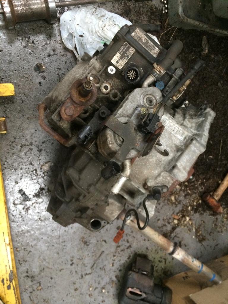

Just been playing about on fleabay and noticed a 4HP-20 gearbox for sale.out of a 2.2 C5 now that's got.me pondering, are these switches definitely unavailable from Citroën?
Steve
http://c6owners.org/index.php
Posts: 52784
x 7241
Re: V6 Xantia......... the beginning of another adventure
Steve,
PM me your address (or a suitable alternative address) and a switch will be in the post to you later this morning..
Has to be today as this is the only day I can get to a Post Office at a reasonable hour..
OK?

Switch is now in the hands of Postman Pat and his colleagues. It should be with you tomorrow..
A 13mm spanner, a screwdriver and a small 10mm socket is all you need to swap it. 30 minutes from start to end should see it done a treat :-D
And that time includes a cup of tea half way through :wink:

NO I haven't removed the gearbox before you ask or shout at me, this is a picture of the one destined for Jim, but it got me thinking....... Can somebody highlight the switch I'm changing to give an idea.
Steve
Posts: 9973
Joined: 09 Nov 2005, 23:03
x 1067
Unread post by xantia_v6 »
Do you see the cable with a connector clipped to the heat exchanger? The switch is on the other end of the cable.
