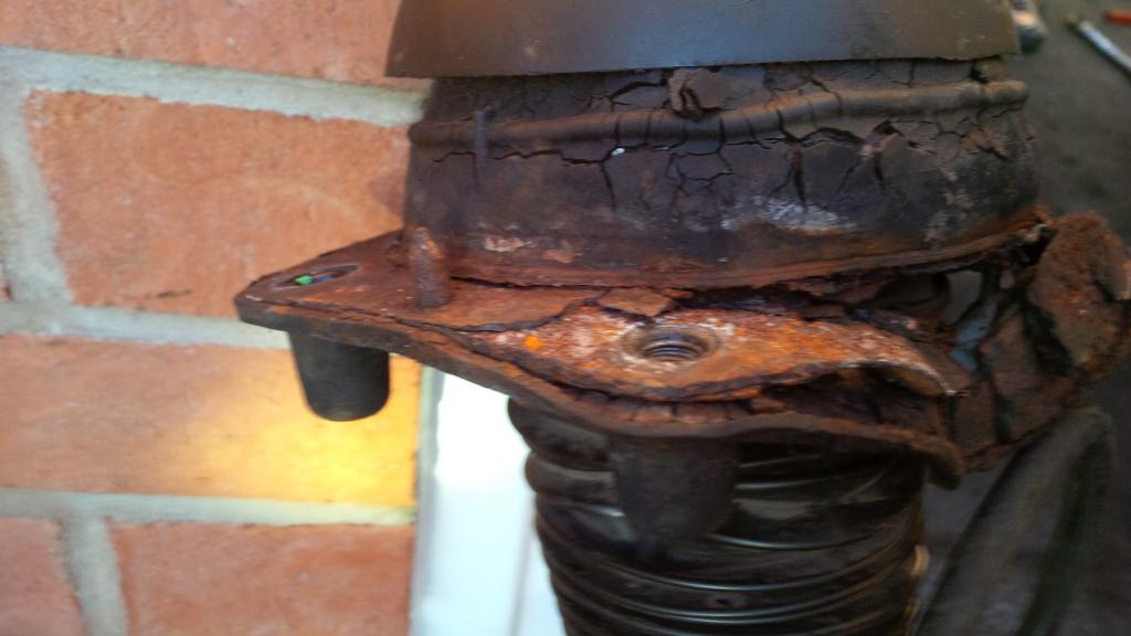

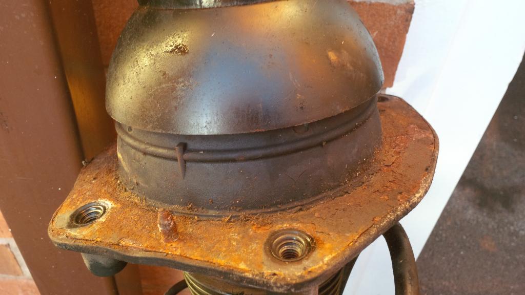

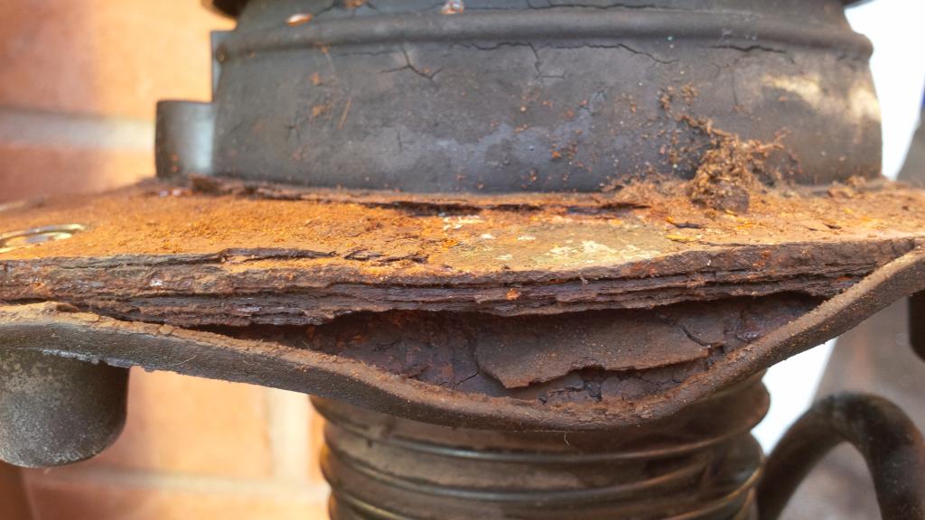

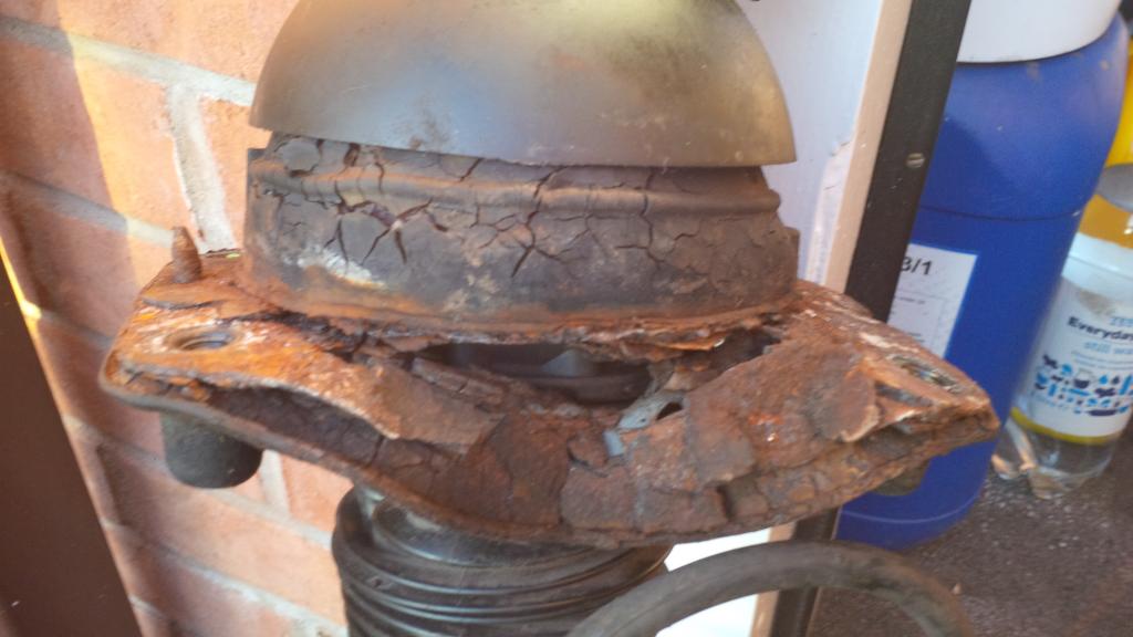

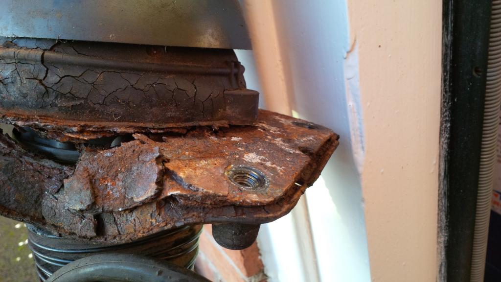

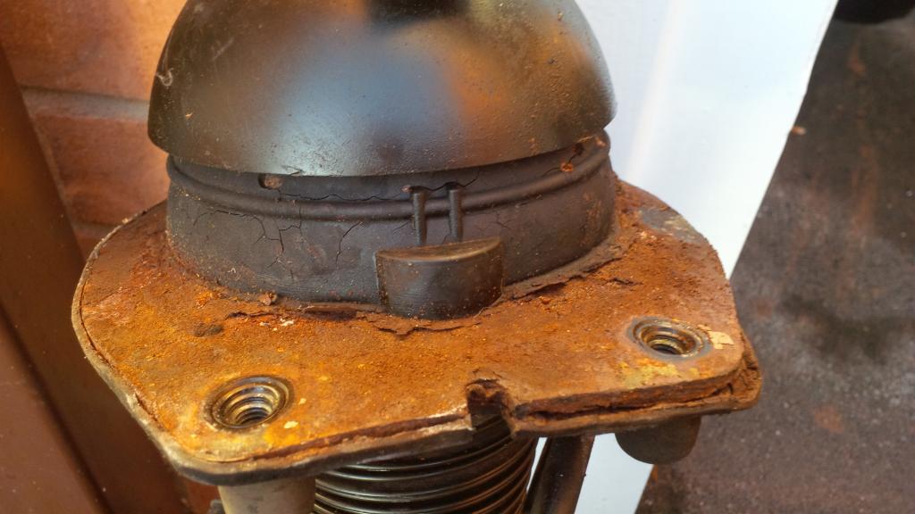

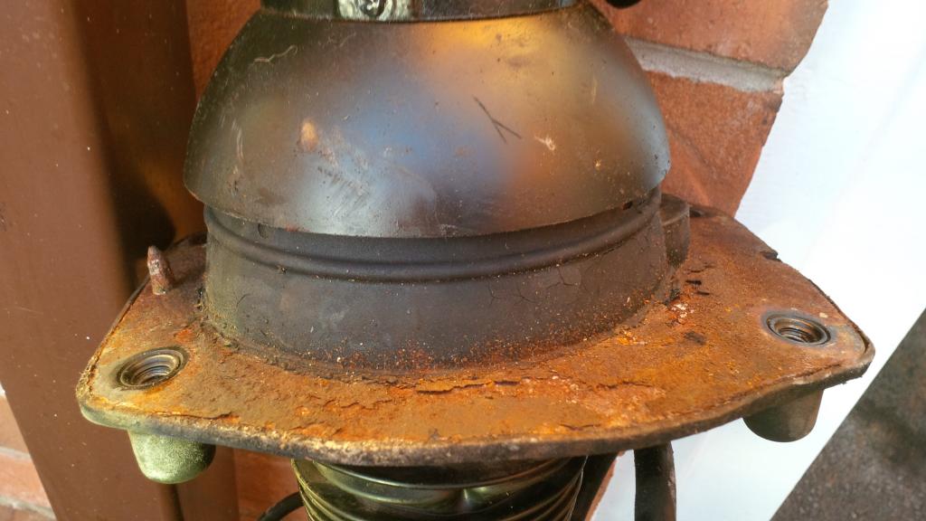

I took some more pictures of the two strut tops, this is the good one......
This is the one that's most definately "beyond economical repairs"
The struts are off a Mark 2 Xantia V6 so therefore the tops are different to my Mark 1, If anybody can make use of the good one or even the bad, let me know please, otherwise SWMBO will be giving instructions to get rid of them.

Even on the good one that rubber has started to crack which makes me wonder if applying some silicone back to black type stuff would help keep them from drying out with age? They had been stored wet in a garage for a long time with the rest of the car before i got to it and after the sills its no surprise other bits were going to have suffered from not being dry stored
Glad that some bits are going to help you out though steve
wonder if the struts themselves are the same between mk1/mk2 as they could be a worthwhile upgrade if someone fancied them
