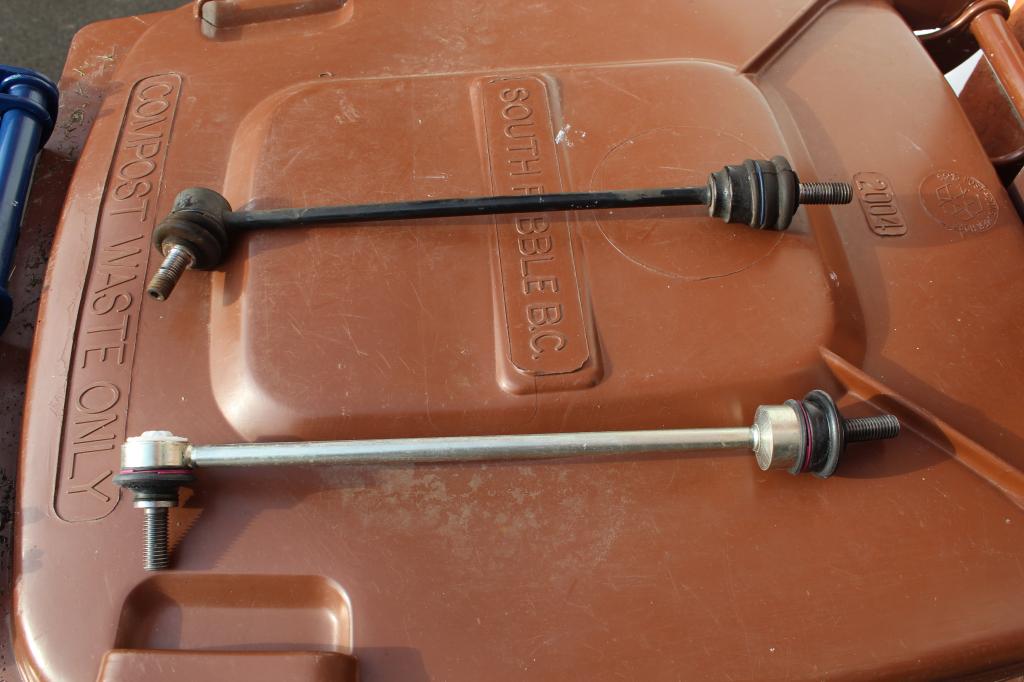

It's been a productive day, First job this morning was to change the drop links, as I said before I managed to a acquire a pair of OEM ones via a link David sent me
This shows the old and the new for the drivers side 8-[

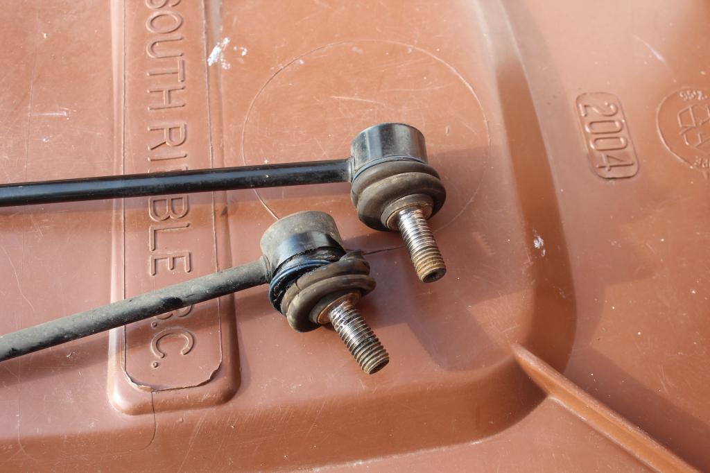

This one shows the Drivers side at the top and the passenger side at the bottom...... it's no wonder I could hear a 'knocking noise' :shock: :shock:

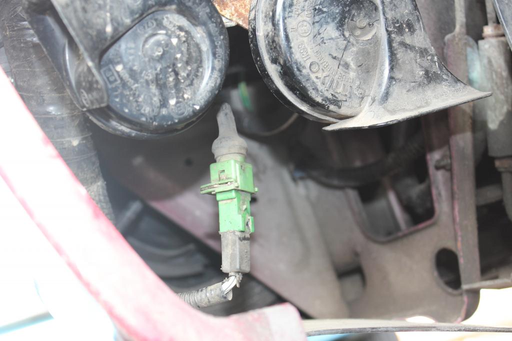

The next job was to tackle the non-functioning front fog light, yes Jim, it was the connector, absolutely filthy, a good spray with contact cleaner and all is well again. Here's the offending connection :roll:
