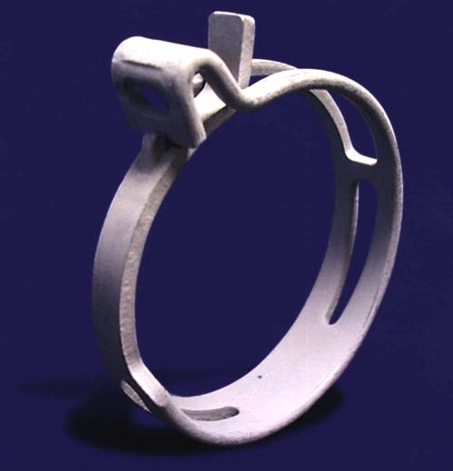

My comments were assuming that we are talking about the sort of 'constant tension clamps' that seem to be used on most of the hoses on my C5 X7. One supplier describes these as follows:
NORMACLAMP(R) FBSC constant-tension clamp compensates for changes in hose diameter due to fluctuations in temperature. One-piece design seals and automatically re-tightens when hose diameters increase or decrease.
They look something like this. (Shown in its 'pre-opened' state):
