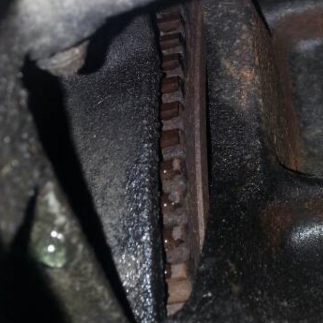

Not meaning to be the purveyor of doom but could it be the head gasket going and leaking externally? Not sure if that is the way they fail on that unit?

Are there any core plugs on that end of the head ?

Depends, you wouldn't get much of a look in with a fair coolant leak.
If it's something particularly bad like a cracked block or what have you then it'd make a good project for someone for spares money. But if it's something like a core plug or a leaky hose or joint somewhere someone would be set to make a fair profit for not much work.
I really wouldn't think it'd be a head gasket failure, they tend to fail around bits that get particularly hot first; like between cylinders or between the cylinder and coolant jacket. If things were so bad that coolant was p!ssing out between the head and the block there'd probably be a few more problems...

Mike, I've an Activa head on the bench at the moment so later I'll check the locations of core plugs and so on.
The drain Chris speaks of is high on the LH side of the bulkhead and drains the heater plenum. It looks like a little elephants trunk.

it seems that it's coming from above, somewhere around the thermostat housing. As I said earlier the transparency of the drop, is suggesting that it's coolant not engine oil, not gearbox oil, Also not heater matrix failure, the location is wrong. I think that's good news. Another good news is that CitroJim has a same kind of car on the bench at the moment
Did you try with bare hand under the thermostat housing? Try it before engine and coolant gets too hot.
Flywheel is not wet all the way. I guess it's a seal or loose plug up there.

superloopy do you have access to service pages? If not tell your engine (is it 2.0 8V or V6?) and I can add pic of the parts we are checking for. Even better PM your VIN code to me.
