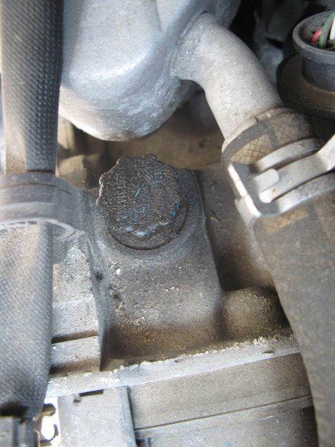

So got the air box out the cap was covered in oil!
Another sign that someone may have already changed the oil? Or just me being paranoid?
What's the worst the can happen if I drain it and fill with LT71141 if someone has put another oil in it? I don't think there's anyone here that can flush the gearbox properly so I'm guessing ill be screwed either way!

Take a picture of the colour of the oil you drain out in one of your sample jars. Normal LT71141 is translucent yellow, most (but not all) Dexron oils are cherry red.
If its dirty it will most likely be black either way! Don't panic if you think the wrong stuff is in there, worst case scenario is that you might need to do 3-4 changes spaced over a couple of months, 4 changes is almost as good as a flush from what I can see as that got mine from pure black to bright clear yellow.

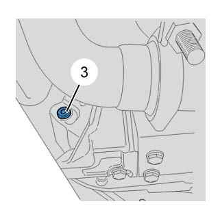

Now I should be more embarrassed!!
I thought the drain hole was the same as the oil level hole! probably lucky I couldn't reach the drain one very well! I did think the instructions seemed a bit strange with using the drain hole for level checking. That could have been rather bad.
Along with this pic looking not really like the actual drain plug:
Will have to see if I can find that level plug then (haven't seen anything obvious though it could be covered in oil like the top cap) Hopefully it's more accessible, and I can still do it without spending more money.
EDIT: AHA, I found out where the confusion has came from: http://www.xantiav6.co.uk/forum/AL4%20Oil%20Change.pdf" onclick="window.open(this.href);return false;
The AL4 has the drain/level plug as part of the same thing. I must have got it in my head that the 4HP20 had the same thing

The sump drain plug should be right at the bottom like the sump drain plug on an engine. The level plug is usually a few inches up the side of the gearbox, but as I say I don't know exactly where it is as I don't have the later version of the gearbox with the level plug. (I think they switched to level plugs instead of dipsticks around 1999 on the Xantia, so mine is one of the last dipstick versions of the 4HP20, thankfully, given the number of oil changes I've done! )

Thanks Simon, I think I know where it might be, as I think I recognise that cross member in the pic, as I was wondering if it could be used to place the axle stand under (decided against it in the end anyway), so that should give me a reference point to check. If I have time I might go and check it out at lunch time.

That pipe in the foreground is one of the exhaust down pipes too, that should help locate it!

Think I've found it (well a bolt all on it's lonesome ) Probably should have re-looked at my print out with the image above on to get the right angle of it. Pretty sure that's an O2 sensor in the foreground in the 2nd pic. 1st one shows where it is in relation to the drain plug.
That should be reachable

I can see the drain plug on the left hand side in the first picture (not visible in the other two pictures) but I can't see anything else that looks like a level plug Ben ? Can anyone else see one ? Perhaps draw a circle around what you think is the level plug.
PS because your images are close cropped and the camera is at a various different angles its a bit hard to identify which way is up, which way is front and back etc
