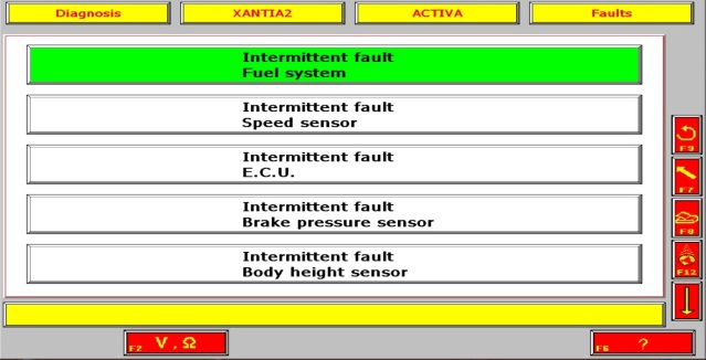

Also bought a Lexia and here is what faults activa ECU shows:
Erased all the faults, went for a ride, connected Lexia again and no faults were shown. Everything seemed to be ok, but in the morning after a few miles the electrovalves went off again.
Any ideas why this happens?

Re: Xantia stuck in hard mode
The large number of individual intermittent faults logged by the Lexia suggests to me that there is a bad electrical connection to the Hydractive ECU, have you used contact cleaner on the two connectors to the ECU ? Its extremely unlikely that all those different sensors are individually faulty.
More likely the ECU connectors are oxidised, or there is a fault in the power supply to the ECU, (bad ground or bad positive feed via the fuse box) or an internal fault in the ECU.
Did you go into the individual faults to get more details, in particular the Intermitent ECU fault ? What did it say ?

The ECU connectors are ok, unpluged and checked them when doing the diode mod.
No didn't go into individual faults just erased them, but will connected Lexia again (maybe on Sunday) and I bet the same faults will be present.

I assume you mean when unplugging F8 and then refitting it the valves start to work ?xantos wrote: Like I said when unplugging fuse F8 the valves start to work. Like the ECU needs a reset. Lexia couldn't connect to activa ECU when the valves weren't working.
You didn't mention before that the ECU stops responding to the Lexia when the electrovalves stop working, and then starts working again after the power has been removed and reconnected.
This really does sound like either you have a marginal power supply to the ECU or the ECU itself is faulty. No electrovalve faults should cause the ECU to stop responding to queries by a Lexia. It's almost as if the ECU is crashing and requiring a reboot.
