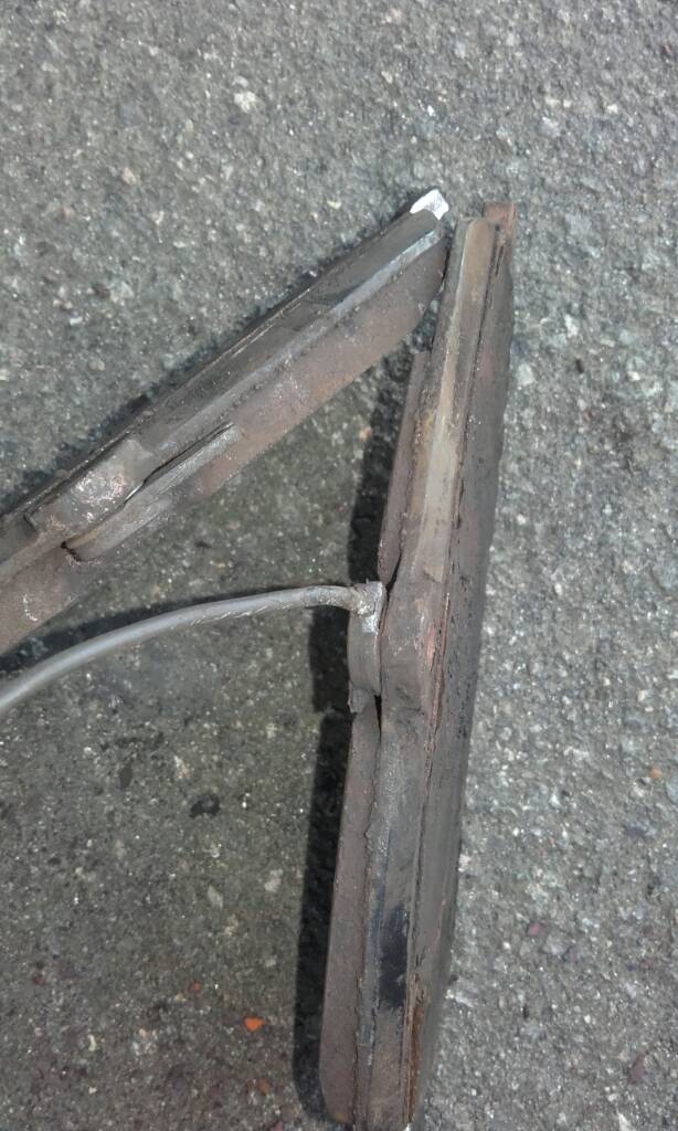

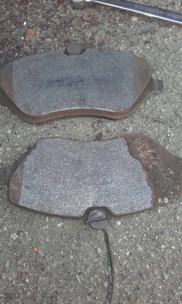

Big pug got a fail. A binding brake, caliper is now freed off but I need brake pads. I blame whoever fitted the full set of pads, discs, rear calipers, rear brake pipes and rear flexi hoses pretty recently. One pad seized solid in the carrier and has done this to new pads. It also needs one wheelbearing. It's not noisy but in the testers words as rough as a badgers arse. Wheelbearing booked for monday and a set of pads ordered.

It wont be difficult Alasdair. Garage is doing the wheelbearing on Monday, hopefully I will have the pads by then, then its passed. My tester did say the car looks well maintained with all the new brake parts on it, just a pity whoever fitted them did not clean up the carriers very well! I will fit the full set of front pads, and tahe the rears out and refit them just so I know they are tree and stay free in the carriers. On Friday its getting mapped to in the region of 250 bhp and 580 lbft of torque, its a big heavy car, so it will need the brakes to be spot on.Stickyfinger wrote:Easy re-pass, good job Davie

That's just annoying...How could they not notice that when they did the brakes?

I would say they hadnt cleaned the crud off the carriers Zel. 5 minutes with a wire brush and put the pads back in with copperslip and they are working fine, albeit with dodgy pads lol. I had to hammer the inside pad out of the carrier. The other side looks ok but i will change the pads anyway. Hope the 107 is fine. At least they are really simple cars to work on. Ours is running on uniroyal rain expert3 tyres all round. Shaun is doing most of the mileage just now running to Dunecht from Macduff daily. 84 miles every working day on to it. The rain experts are cracking tyres on every car ive tried them on. The 107 has 4 on, big pug has 2, shauns toy civic typer has 4, kerris a4 has 2, all have fantastic grip from them. They are not too expensive from camskill either. I would heartily recommend them for your baby pug, then when your fronts are done move the fronts forward and new on the back again. Maybe manage to use them before they perish! That takes some doing on the back of a 107 lol
