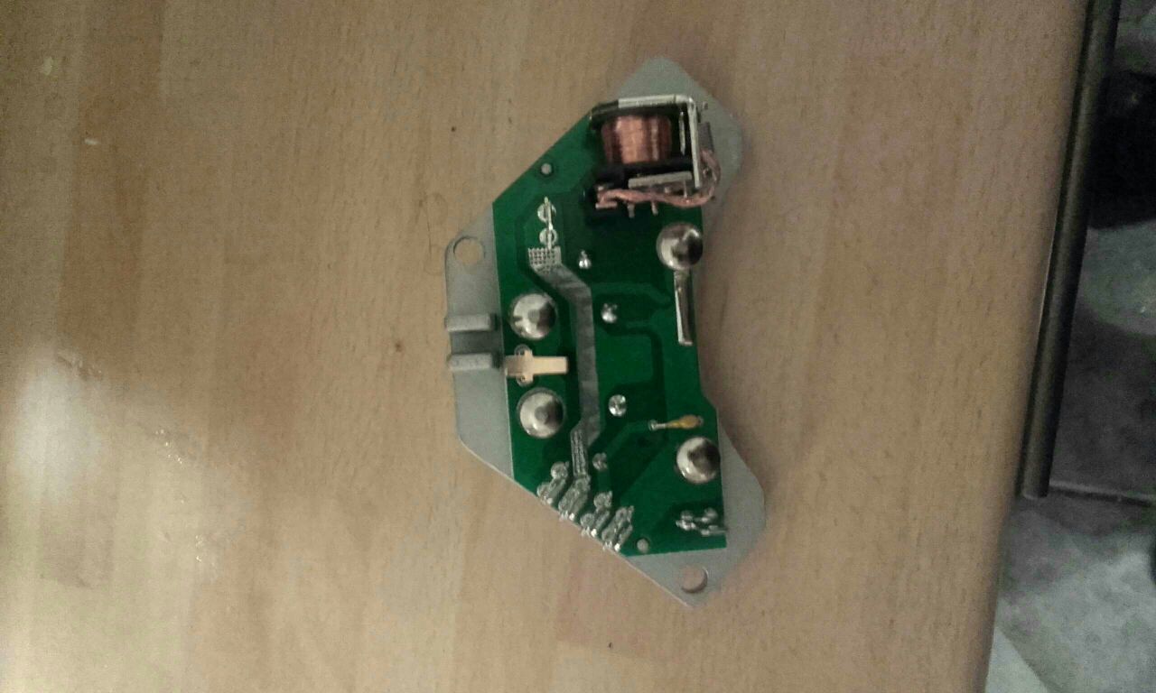

It's been out and tested as the sticky thread about it. I'm entirely convinced it's the box of tricks on the motor. I have had the fan working so it ain't the motor. I do have a new part to fit and I hope it fixes it.

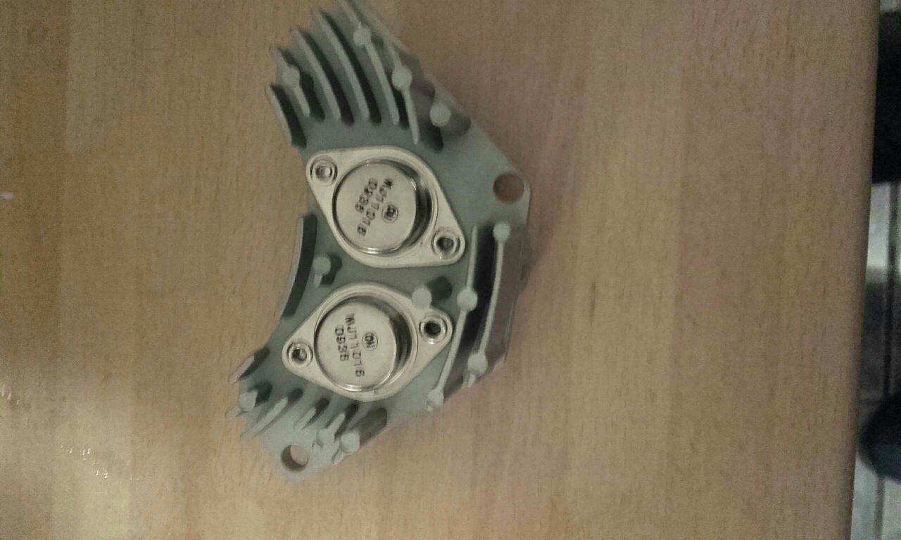

Davie, if that's a regulator sourced from a well-known internet auction site and the transistors have 'MJ11016' written on them, as they look as if they might in the picture, then I' regret to tell you it won't work
Those are the NPN version of the transistor rather than the correct PNP version...
It's a known issue with some sources of these items sadly.
If you want, you can send it down to me for testing and if it does not work I can make it work with a change of transistors - done them before...
At least then, when you are able to swap it you'll know it's a good 'un.
If I cannot make it work I'll supply a refurbished genuine one for you...

They do say MJ11016 0396 on them. The ad said for a 2.0 turbo activa. Bugger. PM your address to me Jim, I should have it somewhere but can't see it. Thanks.

Good job you posted up that picture Davie
Will do in a tic...
daviemck2006 wrote:PM your address to me Jim, I should have it somewhere but can't see it. Thanks.
Will do in a tic...
