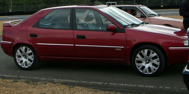

These are photos of xantia on resolfens that I found before I got mine. My wheels have 205/50 x17 at the moment, but will get changed to 215/45 x17 when the time comes. With the tyres on at the moment when on low suspension the tyre is against the fuel filler pipe.i was comparing tyre rolling radius today, 205/60 15 is the same rolling radius as 215/45 x17 to within 2mm. 205/50 x17 is 7mm more than the 15's So the 215/5 will be a better fit. Which is good, as I have two new uniroyal 215 on the wolfrace wheels which have done less than 1000 miles on the back of this car already. So they will get swapped over in the near future, I will run the bugger 205 on the front until I can afford another two uniroyal.

Davie, I have to say those wheels look so much better on a silver car than they do on a red car... On a red car they just don't work as well for some reason...
