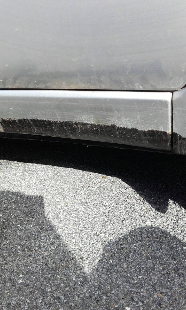

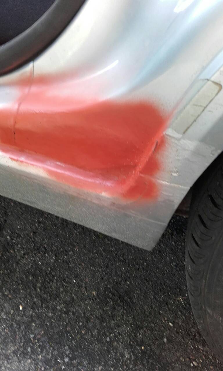

The left rear door shut was just the outer skin which needed work. A little bit cut out and a patch made and but welded in. With a little filler and paint and no one will know it was touched. He had the inner part of the sill on the other side done, just the outer part to do and it's done. It will get the silver hammerite for now until it gets painted properly. I have Shauns civic up for MOT on Thursday, hopefully the activa is ready to get booked in whilst in there. I've had a poke about and can't see anything obvious under it for mot man to find, but as usual that's no guarantee all is well. The civic should pass, it had quite a fail list, Shaun says it is all done, the only thing I did for him was get two tyres fitted. He has done the rest without my help, which is as it should be.

I just got a phone call letting me know the activa is ready to be picked up. The patches have a covering of red oxide primer as agreed and I will be left to do any filling and painting as necessary. I need to get a couple cans of waxoyl with the long tubes to spray the inside of the box sections of the sills, there is grommets on the sills to allow this I think. The weather has broken here, it's cold and misty so I hope I get a chance to paint properly in the next few days or it will just get the silver hammerite brushed on for the winter.

Please do NOT use waxoil, it is to thick and solidifies to quickly inside sections like that....DINATROL (or such like) is a better bet for those areas.
Good coats of standard car primer/paint is better than Hamerite as well mate. (even if you need to take it off later.)

Once there two bits are painted silver the patches will be as if they had never been done. Just maybe the shinnest sliver of filler needed on the door shut. To my eyes he has done am amazing job of fabricating the patch panel in there. £350 spent, but not one bit of rust on the car now.

The rust was cur out in the door shut and he fabricated a panel to weld in. He took 3 goes at cutting and shaping the patch before welding it in. I think once it's painted the repair will be invisible. Also the bit on the sill, it was worse than the door shut. The whole lot was cut out, sill, jacking point, inner sill and into the floorpan. The underside is all stone chipped, it only needs a blast of silver on the sill and again it will be as if it has never been touched. The welder thought it looked as if the jacking point had been damaged at some point in the past. He has made a phenominal job, theres no filler been used, thats his patching and a quick blast of red oxide primer. I am very impressed.
