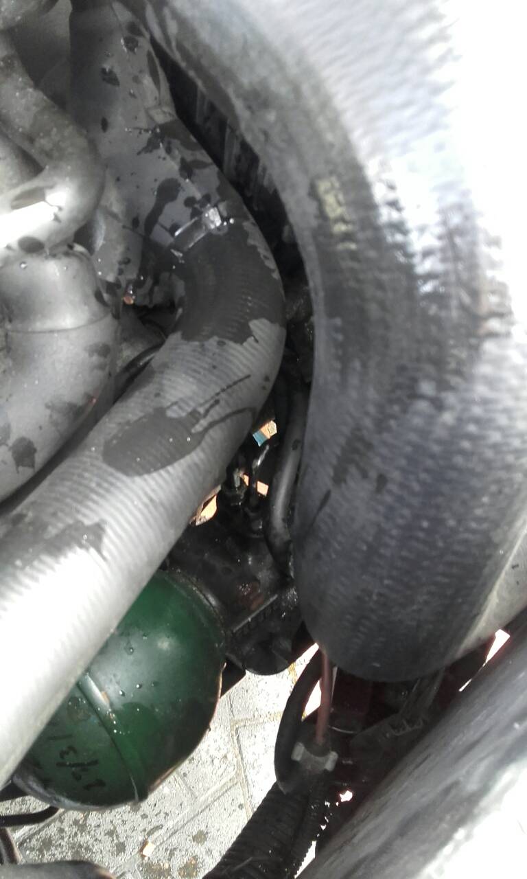

I'm just about returned to the land of living. Enough to get the xantia up on ramps for a look. I found the green leak
There are two pipes going into this sphere, the one nearest the engine was the culprit. Nearly a full turn to get it tight, hopefully that has cured it. Cleaned all the oil off the bottom of the engine, it was everywhere! I then tapped all over the bottom of the car, it looks like the only welding needed will be the left side door shut, and the underside of the sill at the front of the drivers side. I poked about it and it's not that much really and from what I could see and feel with a screwdriver it's only the outer sill. It then got delivered to the welder, he will hopefully get it done in the next day or two. I hope he makes a meet job. I've seen his work, he buys old transits and fixes them up and sells them, so from dealing with old transits he will be a good welder lol. Not that I am saying that transits rust [emoji15] So I will then get the mot done and the couple bits of paint then see what to do.

Ahh that's excellent Davie
I always just nip those and if they leak after a while I nip 'em a tad more...
Pleased it was nothing difficult

It's always a relief when it's something simple!
The night before I went to the Northern 2 years ago I found LHM pouring out of my Activa ram. Thankfully the return pipe had popped out of the spigot on the ram. I popped it back in and put a small cable tie around it and it's been fine since
Relieved was an understatement.

All those pipes presumably we're removed to get to the gearbox when the clutch was done. I suppose with it being a citroen it needs to slacken pipes for fun and to keep the owner on his toes! Bloody car could have waited until I was for to crawl about looking for it, not when I have sciatica!! Pleased it was just a slack joint though.
