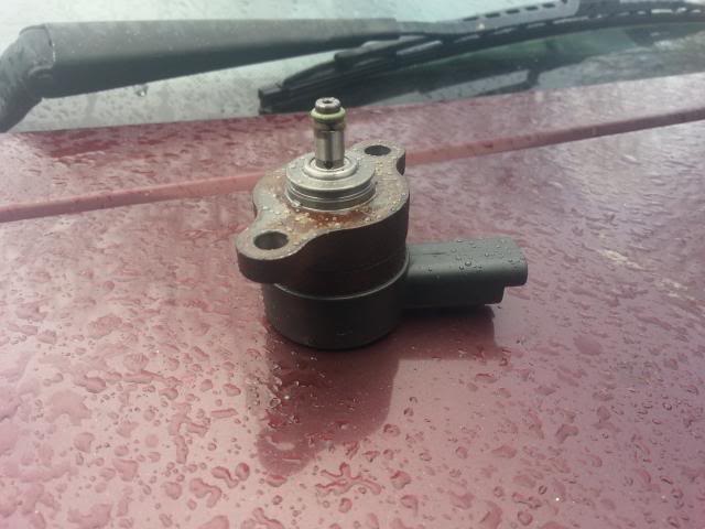

WE HAVE CRACKED IT
Yes we have! It WAS mentioned before be Possibly RichardW, but I brushed it aside as I assumed it was a GOOD Part!
It wasn't, I swapped it for another and HEY PRESTO! OVer 40 HARD pressing miles, no cutting out!
What was it???
Yes, it was! The fuel pressure regulator on the end of the pump!!!
Where was it.? Well, there was a regulator sat on a bench for about 2 years, I assumed was duff. So today I decided to try it, and put it in. It turned out to be working perfectly! So, I must be surrounded by Duff Ones!
What was it???
](./images/smilies/eusa_wall.gif)

Oh. And ordered a NEW Bosch One for 69 quid!

Now if you have a few is it the regulator or dirt in it possibly?
Maybe soak overnight in something like caustic soda, turps, petrol, maybe even nitromors if it's about at all

Nope, NOT messing again, it works and works perfectly.
The one I took out was one that had NEVER been removed from a pump before, however, the tip of the unit had bad wear marks on it, the only time Im changing this again is when the current one plays up, and then it will be a NEW one going in!
