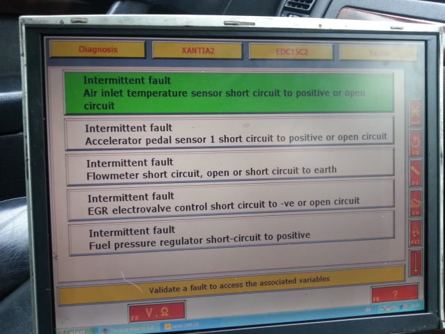

I put lexia on.. here are some of my findings from it...

Some of the recorded faults..

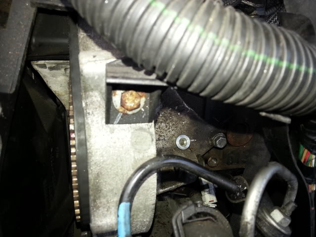

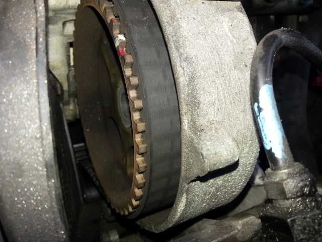

Ok.. so i set up on swapping hp pumps as the car was getting impossible to start..
Removed to engine pump which is perfectly possible to leave the pully inplace on the belt..
And swapped it across...i also swapped the fuel rail sensor for piece of mind..
The result? Still a varying measured pressure value and still cut out under heavy load..
So gonna try one last thing and swap the fuel tank pump...

Paul, I may be really off the money here but the Lexia faults might just indicate an electrical problem on something common to all those items such as a duff/high resistance earth or a duff/intermittent/low supply. That might well account for the odd behaviour. The front loom or fusebox may be implicated.
Did all the faults successfully clear and stay away?
If you need HDi wiring diagrams and layouts let me know...
As I say, I may be wrong but it might bear a check and investigation.

Ooo yes jim they did clear and stay away. The only one to return is the lack of high pressure measurement or what ever it says.
