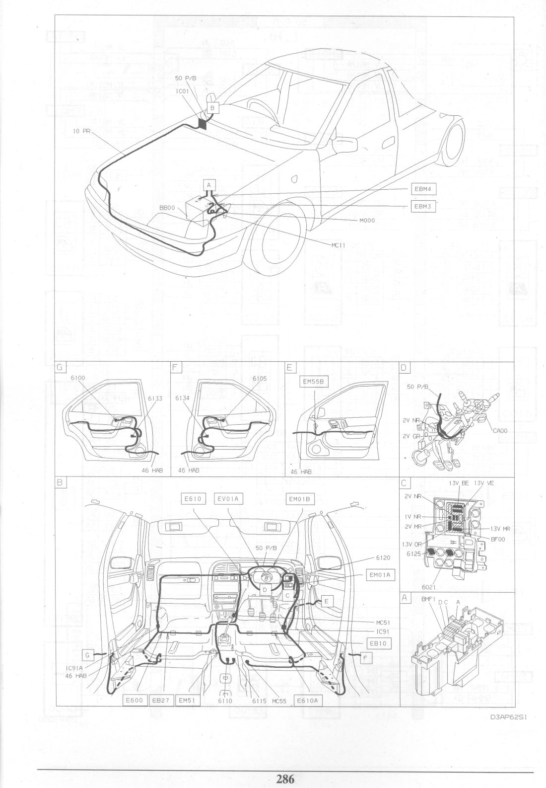

Problem 4. One of the rear doors doesn't lock/unlock with the remote central locking
Is there a common cause for this/easy fix or is it a case of stripping things down and work it out?
3. You will have seen this post? I used to offer a repair service but sadly I can no longer :(
4. This will be broken wire in the door loom where the wires pass via the rubber concertina from the B post to the door.
Here's the circuit diagrams that may help you...
Schematic
Harnesses
Locations
Hope that helps :)

Posts: 14314
x 3296
Re: Calling xantia experts, a few technical faults :(
re 4, I had similar problems with Gracie but worse. The OSR door was not on the central locking, but would lock from the button, but the NSF door was deadlocked and non-responsive. I found failed wires in the sleeving between the door and the pillar. There is enough room to work on them, so I added new lengths (insulated with heat sleeving), and (barring a problem with the alarm thinking a door is open) all of the doors are now on the central locking.
Ignoring the earth wire (coloured green) there are 4 wires involved on the rear door locks. These are all coloured white, but they also numbered, so it is not all bad. I added 0.5m on each wire to allow enough length for movement of the door.
The sleeving is tight where it goes into the pillar, as it goes in quite a way. I would make up a full set of repair wires first (eight in total), and then get on with it. If you can get somebody to help (by holding the wires together as you solder them) it will make the job easier. Otherwise steady hands are needed.
