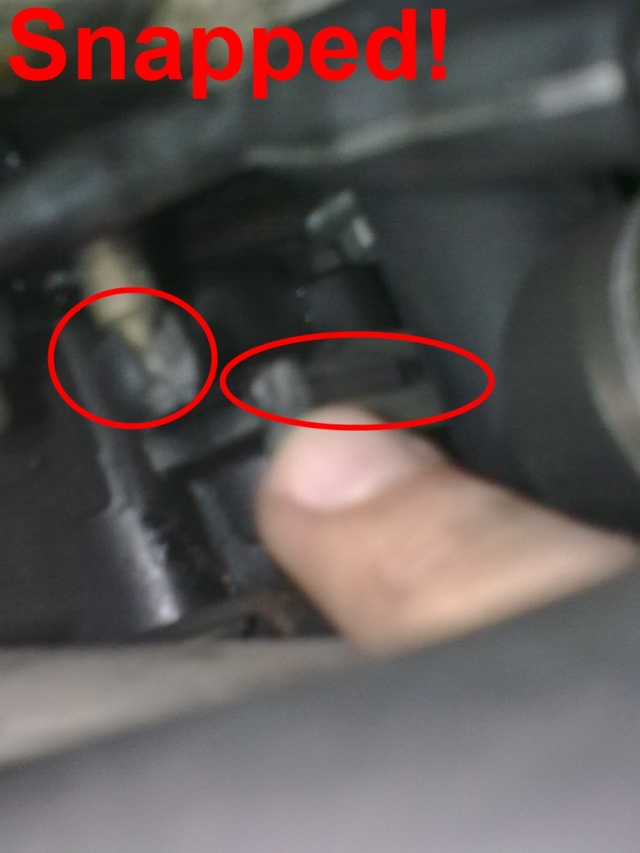

Hi all,
So yesterday, I cleaned the MAF with Halfords Electrical Contact Cleaner. I did my usual 60 mile round trip, that I do 4 times per week (twice per day on 2 of those), and where the car reported 31mpg previously, the figure was 32.5mpg for yesterday afternoon's trip..... in other words only an arbitrary improvement.
So............. this morning (before the rain arrived!) I cleaned the MAF connection plug with electrical contact cleaner, but also then applied some Dielectric Silicone Grease to the MAF plug connections.
On starting the car this morning, it sounded smoother and seemed to pull a bit more 'perkier'. From this morning's trip, I got 38mpg, so we're definitely getting there. A definite improvement with the Dielectric Silicone Grease, because I actually drove the car considerably harder on this trip, some of it in 'sport' mode on the autobox, some of it holding it in '3rd gear' to do a bit of passive regeneration for the FAP, and generally speaking just heavier with the right foot. So to drive considerably harder on the right foot and see MPG increase from 32 to 38 is encouraging.
Now, my next concern is that while looking under the bonnet, I noticed (to the left of the MAF, on the main engine block, just to the lower right of the engine cover), some sort of plastic 'arm' that appears to have snapped where it connects to a small plastic balljoint, on some sort of pivoting device (great description I know!).
To add to my poor description, here is a photo of appalling quality! ........ Hopefully my red text fills in the gaps :-
Can anyone tell me what this is, why it might have snapped, and what the effect would be? ..... Is this the infamous swirl valve arm thingymajig?

Re: C5 2.2 HDi Auto - High fuel consumption?
This sounds lie the swirl arm, doh!!
Mine snapped and I ordered a new one and just change the ball joint as the valve seemed fine.
Would there be no other noticeable effect from this snapping? (the car appears to run fine).waynedance wrote:This sounds lie the swirl arm, doh!!
And could this be a contributor towards the poor fuel consumption would you say?
The swirl arm changes the car from a 12 valve engine to a 16v at 2100rpm. Its another common failure, cost about £40 from memory buit a real pig to fit the thing cos of restricted access. See the link for my original post...
Thanks SaabC5, that's a very insightful post, and yep this is definitely what has snapped on mine. Although not as good as changing the whole swirl valve, the 'snap' at the ball join bit was very clean and I have been able to rejoin it (for now) with some superglue. The glue is drying, after which I'll test it as off out to work at 6pm.SaabC5 wrote:The swirl arm changes the car from a 12 valve engine to a 16v at 2100rpm. Its another common failure, cost about £40 from memory buit a real pig to fit the thing cos of restricted access. See the link for my original post...
http://www.frenchcarforum.co.uk/forum/v ... rt#p287273
I am wondering whether my car has been operating on 12v only or 16v only! ..... I'm hoping for either a good economy or performance gain, depending!
I wouldn't have thought so, twin turbo cars tend to be sequential. The second turbo is always spinning but really comes into play and spools up when you ask for instant power.mooseshaver wrote:Is that the same on the twin turbo?SaabC5 wrote:The swirl arm changes the car from a 12 valve engine to a 16v at 2100rpm.
Try Citroen for the swirl valve actuator, mine was £22 (July this year). Best bet for drive-ability in the meantime is with the arm cable tied back towards bulkhead.
Thanks. However the supergluing operation was successful for now ... rod back in 1 piece and operating fine at the required revs. I can't detect any extra performance (as someone reported having repaired this break) but I did my usual 60 mile run and got 38mpg again.Monkeyfeet wrote:Try Citroen for the swirl valve actuator, mine was £22 (July this year). Best bet for drive-ability in the meantime is with the arm cable tied back towards bulkhead.
I suspect that's as good as it's going to get from this car/engine. Definitely the most thirsty diesel I've owned (including a BMW 530d which just beat the C5!), but a lovely drive overall. Had I done my research, I think however I would have gotten a 1.8i or 2.0i petrol C5 over this HDi, given FAP considerations, fuel economy, servicing, etc.
Just an update ........ well the swirl valve actuator rod snapped again at the balljoint (where I'd superglued it!)..... so I am back on 16v only (without the 12v retarding below 2100rpm), so my average mpg is back down to 33mpg, but I've decided to leave it alone for now.
