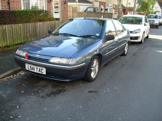

RIP Fifi VI. She's been a goodun to me, put 100,000 miles on the ol' bus.
Rather than post a picture of the mouldering wreck, I've posted instead a picture of her in her pomp.

And very nice too!Xantianut wrote: Rather than post a picture of the mouldering wreck, I've posted instead a picture of her in her pomp.
