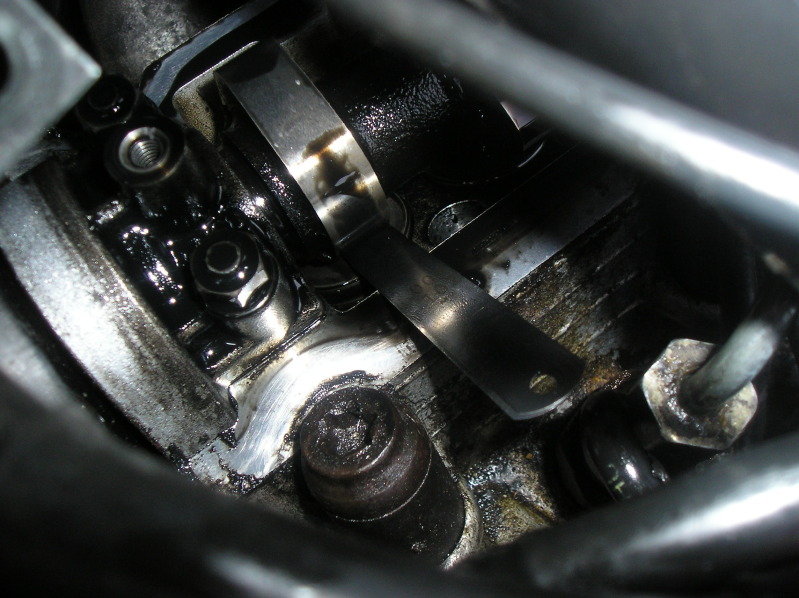

Right, valve clearances have been measured:
The inlet is supposed to be 0.15 cm, + or - 0.05mm;
the exhaust is supposed to be 0.30cm, + or - 0.05mm
These are the measurements I got:
Inlet 1 .004
Exhaust 1 .011
Exhaust 2 .011
Inlet 2 .006
Inlet 3 .006
Exhaust 3 .011
Inlet 4 .006
Exhaust 4 .011
So they are all reasonably close to each other, but very far out of their tolerances. But due to their close proximity in tolerances I don't think they would be causing an issue.

You are probably right, as long as there is some clearance the valves are actually closing, I have come across them with no clearance at all - and the engine has still been running although not as well as it should be. Does it always miss just on one cylinder?
