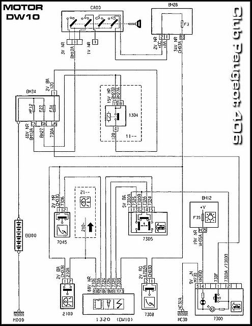

Re: Lexia or KWP2000? Retro fitting Cruise Control on a Xant
I have a gift for you
Cruise Control schematic for Peugeot 406 HDI without BSI
This can also be made on Xantia, but not on all ECUs. The older ones do not have option to activate it.
I have just purchased a newer ECU that should have this possibility. Later I will try to copy only the software to an older ECU, to see if it can run this way.
No it can't!PIT wrote: This can also be made on Xantia
All Xantias originally fitted with cruise used the Hella electropheumatic system with a mechanical linkage to the throttle butterfly. There is no provision in any Xantia ECU for 'fly by wire' cruise as utilised in the 406 circuit as show above...
I wouldnt be so quick to dismiss that Jim. If the 406 HDi ECU has the provision for it in it's programming then why would PSA change it for the Xantia? Also (i'm not sure here) but LHD HDi's may have had it drive by wire. at the end of the day it's all down to the programming, IF the xantia has it then there is no reason that i can see that it cannot be added. (i'm not talking about a legal standpoint here either.)CitroJim wrote:No it can't!PIT wrote: This can also be made on Xantia
True enough Chris but show me on the Lexia where you may enable it. I've not seen it. Also, I'm not aware the HDi has the wiring in place for the column stalk. I'm sure we've been here beforeChris570 wrote:IF the xantia has it then there is no reason that i can see that it cannot be added. (i'm not talking about a legal standpoint here either.)
If it were possible I would have thought Citroen might have offered it as an option on the Exclusive HDi. As far as I know they didn't. This would have been the only one as apart from the 2.1TD (IIRC) that had a throttle pot rather than a direct bowden cable to the throttle butterfly or load lever as appropriate.
