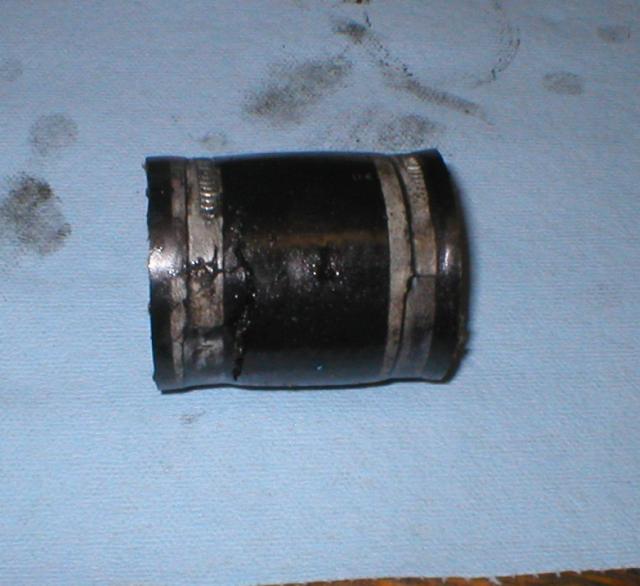

I replaced the little turbo stub pipe because it was very clearly split and causing the major boost leak. So bad was the leak I could hear a hurricane blowing in the engine bay on hard'ish acceleration!
This was the split:
That little pipe makes all the difference. The bicycle patch did not hold for too long on the intercooler pipe but a better bodge has now been carried out...
