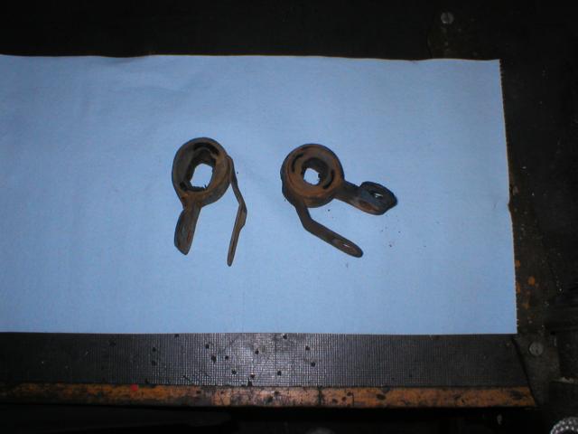

The RH 'P' bush and flexi are now replaced
The RH 'P' bush was not quite as bad as the LH one but it too was in two parts... The angel grinder was essential to help drive off the old inner sleeve.
Here they are. LH on the LH side...
