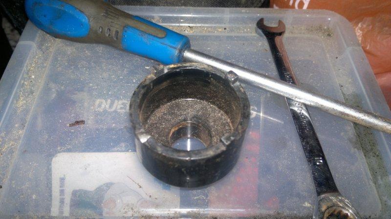

Then the swivel joints themselves wouldnt undo with a 5ft extention bar, Liam (Hydrocobra) popped round and between us we managed to get one off with me pushing the bar onto the hub and him practically jumping on it. It was tight all the way off!! Here's a pic to show you the amount of force...
Then came the turn of the second hub....
This happened....
In so doing it chewed up the swivel joint so badly a tool could no longer be used. Cue massive swearing.
This happened....
