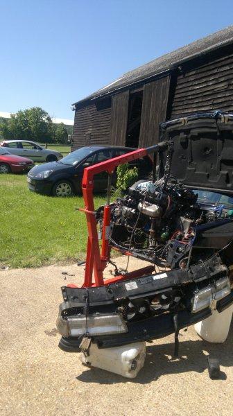

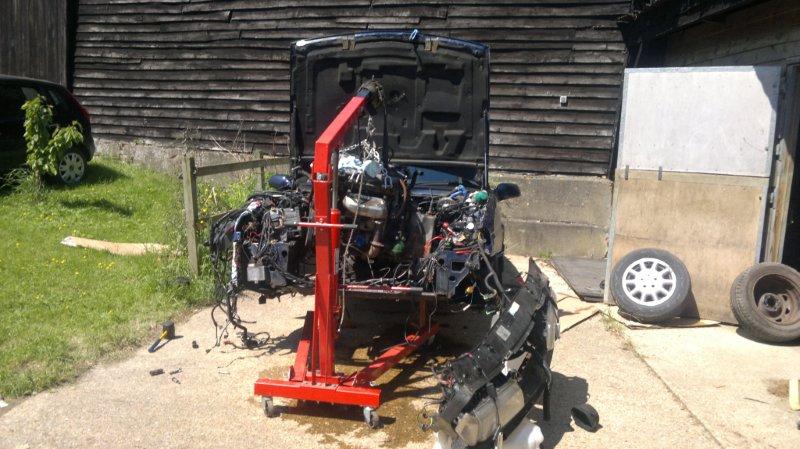

Well they say a picture says a thousand words, so have 2000
The gearbox is off the old engine and now i need to strip it and build the new one up.....
The strut heads were total b*stards to say the least, the big nut on the top was easy enough to shift but for the life of me i could not get the piston to seperate from the head. Much WD was used to no avail, big rubber mallet onto wood with ever increasing violence was showing no results. So I VERY carefully (so as not to damage threads) got the lump hammer out and after some substantial force was given they both dropped. I'll be popping an e-mail off to a lovely man in the EU in a minute arranging collection of the strut heads so with any luck they'll be back either just before or just after the engine is back in.

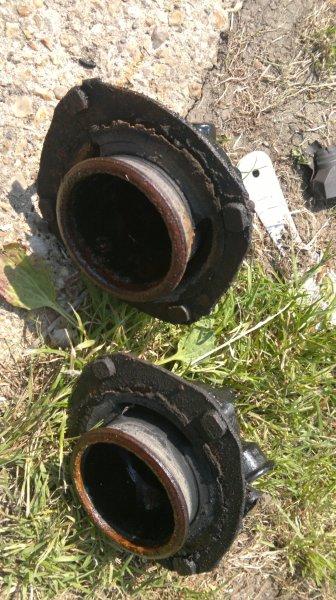

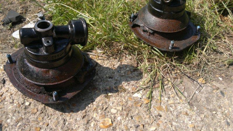

As promised here's some pics of the strut tops...
If you think you can see a split, you can.....
