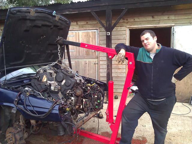

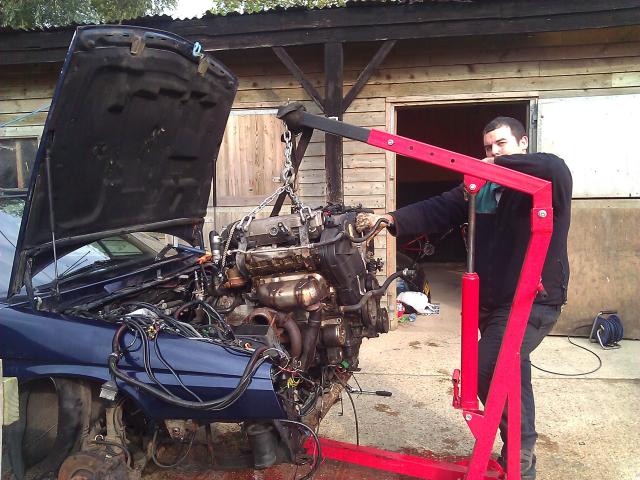

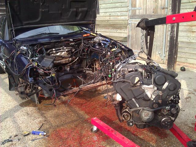

Some pictures from today's engine lifting adventures...
I shall let Chris tell the story. being an XM, there's a big one to tell but all I can say that in general it's an easier V6 to remove than the same engine is in a Xantia :-D
She bled a bit, all that pink stuff is spilt coolant, not our blood although some of that was shed too :lol: :lol: :lol:

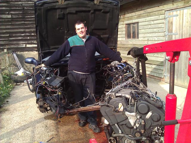

Thank you so so so so much for your help Jim, hopefully the hard part is now over...
I can't say how glad I am that the engine is out words won't cover it... At least I didn't poison you this morning :)
Now the fun part of getting the box off the engine, TDC sensor is off need to get the other driveshaft out, that looks like its going to be a barrel of laughs... 8-[

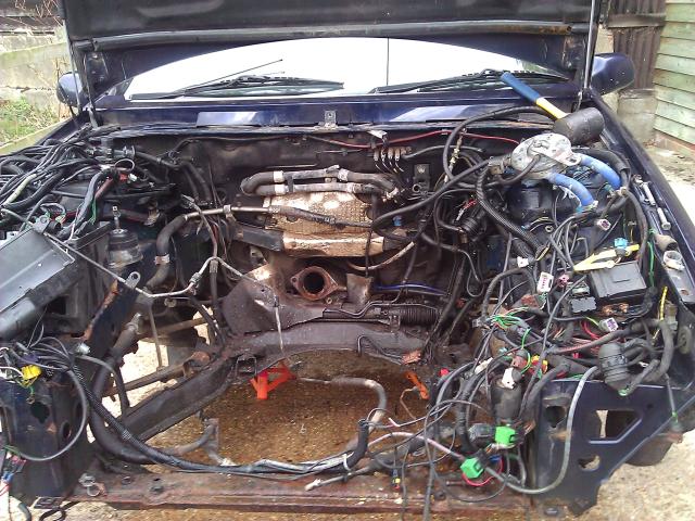

I suppose I should have stopped after we got the engine out but well, it was sunny and I could see the rust, and oh god can you see it..
so time to set up
more rust..
a much better look i hope you'll agree...........
My plan is to go over the entire under-bonnet area and remove all signs of rust, I didn't get a pic of the subframe legs but yeah, they will be taking up a fair bit of my time. I do wonder if when making the XM Citroen decided to treat it like a port joint and rub salt into before you start, it really is amazing the difference between the underside of this and my HDi which are the same year.
Unfortunately the subframe is too big as I was going to get them both dipped and then powder-coated to stop the tin worm :(
So far the intention is to get the car road worthy again by April so I can have it for the summer before she hibernates again as bad weather sets in.

All xms appear to rust on that front crossmember.
Also worth checking the bumper support as they go too.
Well spotted sir! yes I did used to work there, and my theory is why get my clothes dirty when I can abuse that instead 8-)
As it happens I spotted that when removing the nose cone so i'll be doing the same treatment on that.
