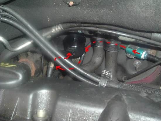

Hopefully you could be lucky, as in your bleeding theory..worth a try. The 'sealed'
(the top just pops off...), small master cylinder reservoir is on the bulkhead,drivers side,(rhd, uk etc) :
