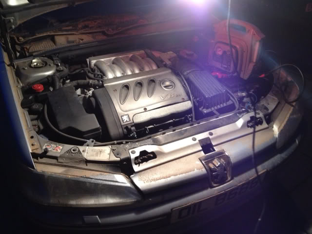

On that v6 I doubt you could get a hand down the Cambelt side never mid any tools

What he said ^
Access is tricky to say the least. You're right about the economy mode, it shouldn't prevent it from starting. I think the issue is a missing power connection from the battery. There's a bolt on the positive connection which has nothing attached to it, and I think there should be another cable coming off it. I remember after swapping a battery on one of the Méganes, everything worked until it came to start when it just displayed "ELECTRONIC FAULT". I'd left off one the 7 separate battery connections. I think this is the case here too. There's nothing hanging around waiting to be attached though.... I need another C5 to compare.

Re: R9UKE's French Car Blog...
Even if you un-fasten the engine mount and drop it down?
Even so i believe its a poop! loose connection somewhere Luke but i reckon a lexia is the only way to go and the sooner the better for it.
Is it turning over? Eco mode does not prevent start or cranking. There is a wire to the main fuse board under the bonnet, just behind the battery, but the fact you have eco-mode showing suggests this is connected (don't be tempted to try and tighten the main +ve feed post on this box - it's easy to snap it off....). Does it give any other clues? Beeping, or flashing the immobiliser light (if it's got one...?). On Xantia V6 Autos there is an interlock on the gear shift so it will only start in park (?) which can be a bit dicky - have you got it in park (and maybe also foot on brake?). Have you tried winging the selector back and forwards a few times to see if that helps? Sadly I don't think a Lexia session is going to be much help, as in Eco mode most things are shut down, and Lexia just reports it can't communicate with the ECUs

I will do, KP, if it ever gets to that stage.
Richard - there isn't even a click when you try to start it, just a beep then the economy mode message again - IN GERMAN. Remote locking works fine, the immobiliser doesn't seem to be an issue. The car "knows" it's in Park, and changes on the display when you shift it into different positions. I've tried N with foot on the brake as well, that's not the issue. I'm convinced the problem is an unconnected wire or missing fuse. It's finding the bloody thing...
