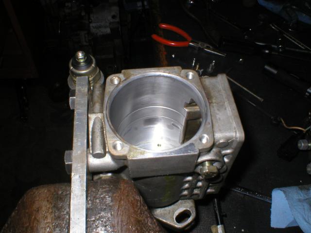

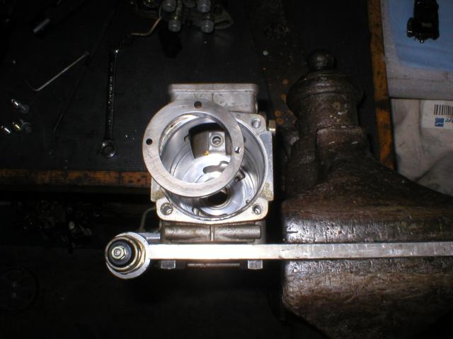

Ron,
I'm sorry it has taken so long to do a decent reply to this thread
I've stripped a pump this afternoon and this is the findings.
The wear you see on the sides of the body in the region of the roller cage is normal... Here's the inside of the one I stripped:
The free length of the spring I measured at 16.2mm so yours is fine.
I made an endfloat measurement by pressing hard on the back of the roller cage and using a DTI to measure the end-float. 0.27mm. Yours at 0.4mm should therefore be OK.
In service, the pressure applied by the two large springs exerting pressure on the roller swashplate via the shim should result in any endfloat being completely taken up throughout the full revolution of the drive shaft. You can check this by assembling the pump fully except for the governor (the weights are not position critical by the way) and throttle plate and rotating the pump to ensure all endfloat is in fact taken up during a full rotation. The two big springs exert a very substantial pressure.
A small witness mark on the cruciform drive piece is normal. It's on the side facing the driveshaft.

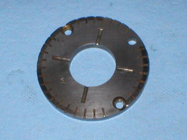

The lift pump ring is indeed "handed". Your man is absolutely correct. This picture shows the correct orientation and it's visibly easy to see. The widest part is to the left.
The wear on your pump plate looks a little worse than this one
But there is plenty of end-float potential on the roller cage and a very smooth witness mark can be seen on the side of it facing the plate. This large range of end-float is normal enough. Having said that, the roller cage should be a good, tight fit in the pump body bore and this can be seen that when reinstalling the cage; it must be pushed into the bore absolutely square or it will bind.
Hope that is OK Ron and I've learned a lot from all of this. I thought I knew this pump fairly well but I now know it a bit better so thanks for that!!!

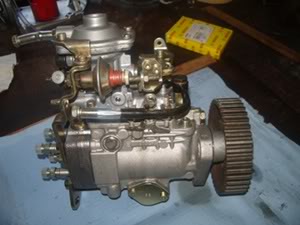

Pump is back from the being recalibrated. I wasn't going to bother but the guy offered a really good price and allowed me to watch the process so I had to satisfy my curiosity. Interstingly I was only a fraction of a turn out on the max fuel screw and all other adjustments were within spec. What the bench flow test was able to determine was that the plunger and head are worn and are only flowing to minimum spec. Not enough to cause problems yet, but something to be aware of for future. Plus I was shown what is involved in reeming the front housing bushes if ever I go that far. Beware if you want to tackle that job, as a special reeming jig is required. Not just a hand reemer. Other than that the pump is now working perfectly and is ready to be fitted. Weekend calendar is full though so it will have to wait for a few days.
At last
Hi Jim.. Well I finally got the pump back on and running today. I ran into another delay with a broken stud on the top engine mount.
It seems to be running fine under most conditions but I now have a cutting out symptom as the car slows down. It seems to occur mainly on the over run when in gear and slowing for a corner or traffic. The motor cuts out at the most inconvenient of moments. At first I thought it might be air in the system and so I re bled the filter can and also the pump via the return line. That didn't work and so now I'm thinking what to do next?.. The Idle speed on the instrument cluster tacho shows 500RPM so I'm wondering it resetting the idle higher might help?.. Have you come across this symptom before?

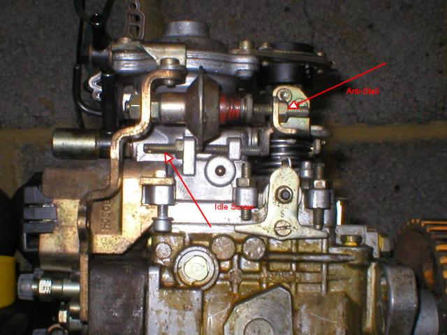

Idle with a warm engine and the fast idle cable slack should be around 800 to 900 rpm.
It may be that and also your antistall wants adjusting a bit too.
Set the idle speed first then see how it is, as when you adjust the antistall the idle speed changes slightly anyway.
Andy.
- spider
- Posts: 3949
- Joined: 05 Jan 2010, 14:28
- Location: Derby.
- My Cars: Soon, I hope...
- x 77
- Contact:
Yes, the fast idle is the waxstat one. As long as its a bit slack when the engine is hot (ie: its not pulling the lever) that's fine.
Erm, I would show you which is the idle and which is the anti stall but I don't have a Bosch pic to hand.

Hi Ron,
Excellent news
The idle screw and anti-stall adjustment screw are shown in this picture.
As you look at the pump, these adjustments are on the back.
If your pump does not have the damper and anti-stall screw exactly as above then it'll be necessary to adjust the idle screw and the screw that works on the fast idle lever plate in combination to get the right idle speed when warm and to ensure the engine does not falter as the throttle lever is rapidly moved from near full-open back to rest. I suspect that just upping the idle will do the trick for you...
