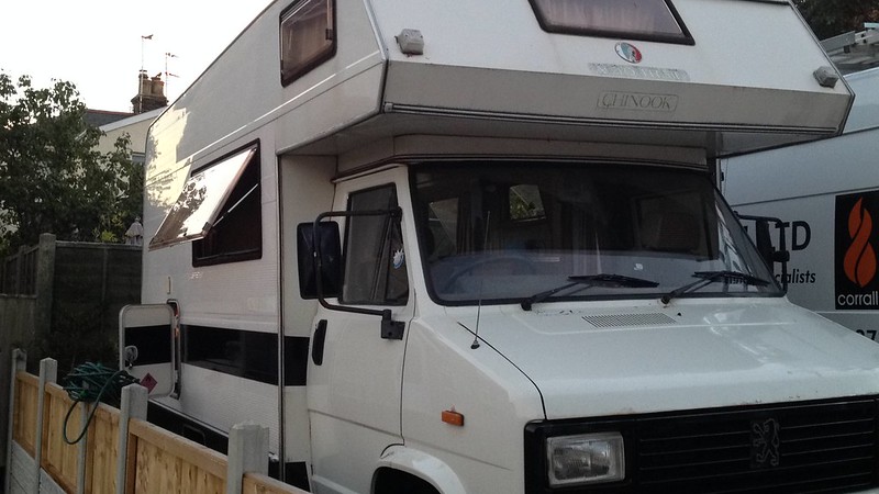

I am also now the slightly ashamed owner of a 1989 vintage Coach built Autotrail Chinook on a 2.0 petrol, Talbot express chassis, this thing is a rocket ship, in that it is noisy, shakey, thirsty and it is always in the back of your mind while driving it that what you are doing is insanely dangerous, and it could kill you at any time. It has 80's commercial vehicle performance and it has all the crash protection and passenger safety you would expect from a B&Q garden shed strapped to an 80's chassis cab commercial, because that is what it is, only it is not built as well as the shed, and the chassis cab in question has been questionably cut to bits in order for the conversion to take place and then endured 29 years of weathering, corrosion and owner abuse.
And i love it to bits

So far i have serviced it, rebuilt the carb, fixed the myriad of chassis wiring and earthing problems/bodges, completed re-trimmed and reupholstered the interior, fitted a new toilet, fixed the many gas leaks, upgraded the habitation wiring and exchanged the old screws and nails for fuse holders and fuses, rebuilt the entire front 1/3 of the habitation due to water leaks and rotten timber, fitted all new tyres and resealed every window and body fitting on the van.
however lengthy the above list the "To do" list is still pretty sizeable, future works are as follows............god help me.
New clutch kit (last owner "fitted a new clutch mate" but forgot to do the pressure plate and thrust bearing while he was in there)
Gearbox input shaft bearings to cure the simply horrific whine when the clutch is released or the syncros grab a gear
Headgasket (because, 30 year old van)
fit new driver and passenger seats that have foam and springs (current ones are akin to being seated on a clothed skeleton)
Then finally remove windscreen and dash to enable me to......
Remove door skins, wings, bonnet, scuttle panel, inner arches, front slam panel and rebuild the top of the firewall, fab and weld in new lower A posts, inner arches, outer lower arches, wings, bonnet, scuttle, front grill panels, and fab and weld in extensive inner wing patches.
She will then need new shocks all round, headlamps, a full cab respray and underseal/cavity wax.
And a new drivers wing mirror..... And off grid solar setup......and a new rad and heater matrix, coolant hose set, Gear selector relay and tower bush, reversing camera and um, probably lots more.
That was hard work to type out, i think the actual job may take longer
Oh and if that wasn't enough we have a baby due in December, so you may say, i am up to my neck in the proverbial

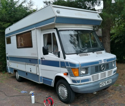

- Posts: 4968
- Joined: 17 Nov 2014, 00:36
- x 1488
Re: Dean's Activa/XM blog
Yay!

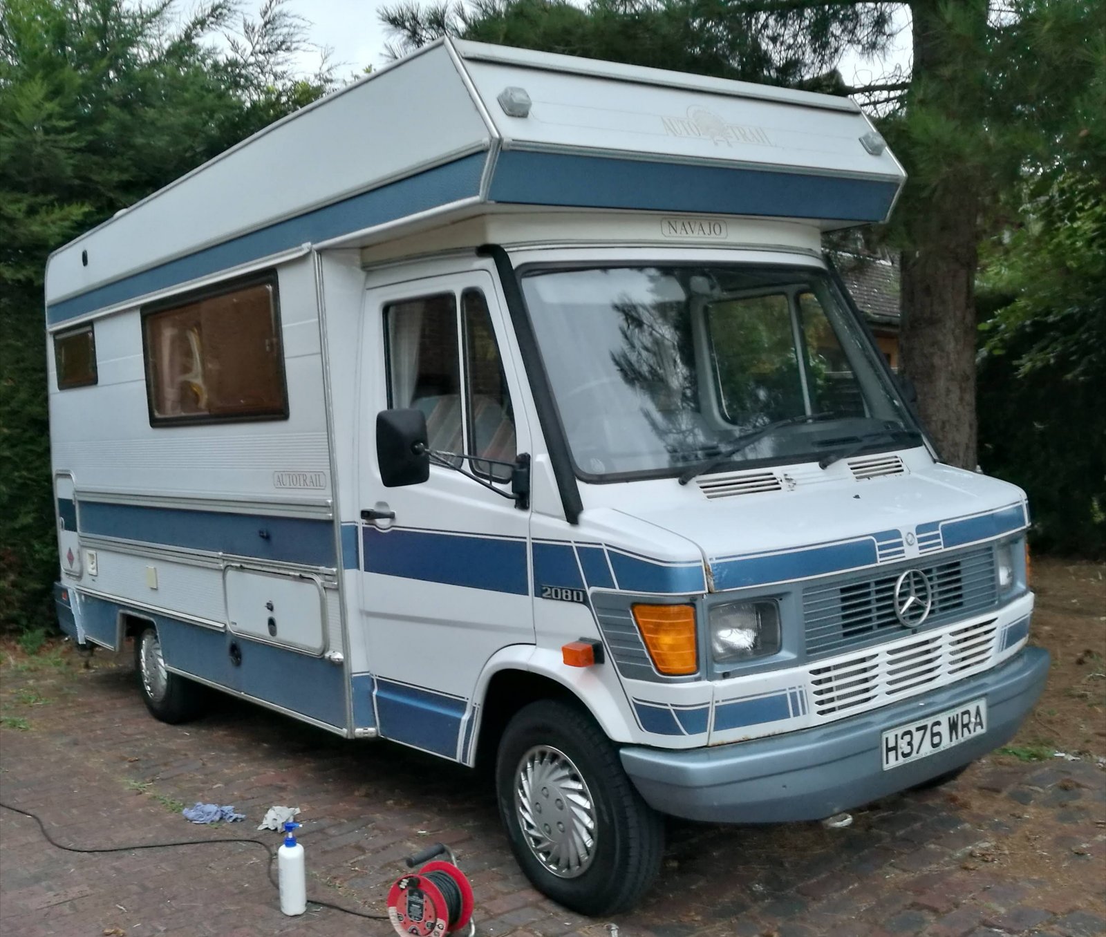

Another AutoTrail owner! Looks like you've got the rarest colour too. Maroon and cream is the standard palette, blue and green being later additions to the range.
Sounds like rust in the firewall etc is just a 70s/80s commercial vehicle thing, as mine has some rot in many of the same areas.
I've never really spent any time around the Talbot Express vans, how does this one handle the open road?
While being an old school diesel mine takes its sweet time moving off from a standing start, she'll quite happily bumble along at 60-65mph all day long.
Reckon it would be really interesting to compare the way these two drive next to each other one day.
Edit: Do you have a copy of the AutoTrail owner's handbook? If not let me know and I can scan you a copy of mine.
Current fleet:
- Posts: 3327
- Joined: 18 Dec 2008, 18:57
- x 87

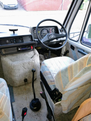

Ha Ha! i had a Merc 308 as a works van years ago, nice bit of kit in a shonky old van kind of way, i think they look nice too.
The talbot is very quick* off the line and pulls hard in 1st, 2nd and 3rd up to 45mph but then the world seems to slow down, indicated 62mph is the most i have had out of it on a strraight long road with a slight downhill run but that was pushing hard, foot to the floor, any kind of hill results in much reduced progress and currently i would think a hill climb on the motorway, say like the you find on the M3 coming up to the winall interchange would result in a top speed of 40mph, not sure if this is right or not. I rebuilt the carb and it starts and idles great now and did pull much better but then i am still having problems again.

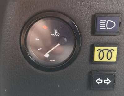

Fitted a new stat as she was overheating, old one would only open 5mm then give up but now she overcools on a run, if the engine temp is at 85-90c she pulls well but as soon as you get moving it cools to 60c, the heater goes stone cold and it developes a big dead spot in the throttle at about 1/4 travel, if i stop the temp comes back up to just under 90c and the engine feels perky and the dead spot vanishes so i think i have a duff stat again and may need to revisit the carb setup perhaps.
On the open road, despite all the piddle taking she is OK, tracks straight, feels pretty comfy, the engine is fairly quiet, she does not have power steering but you only notice when trying to park, the steering is light enough you can palm the wheel but it is a very low ratio to achieve that lightness, feels like 20 turns lock to lock when trying to park but would imagine its actualy 9 or something.

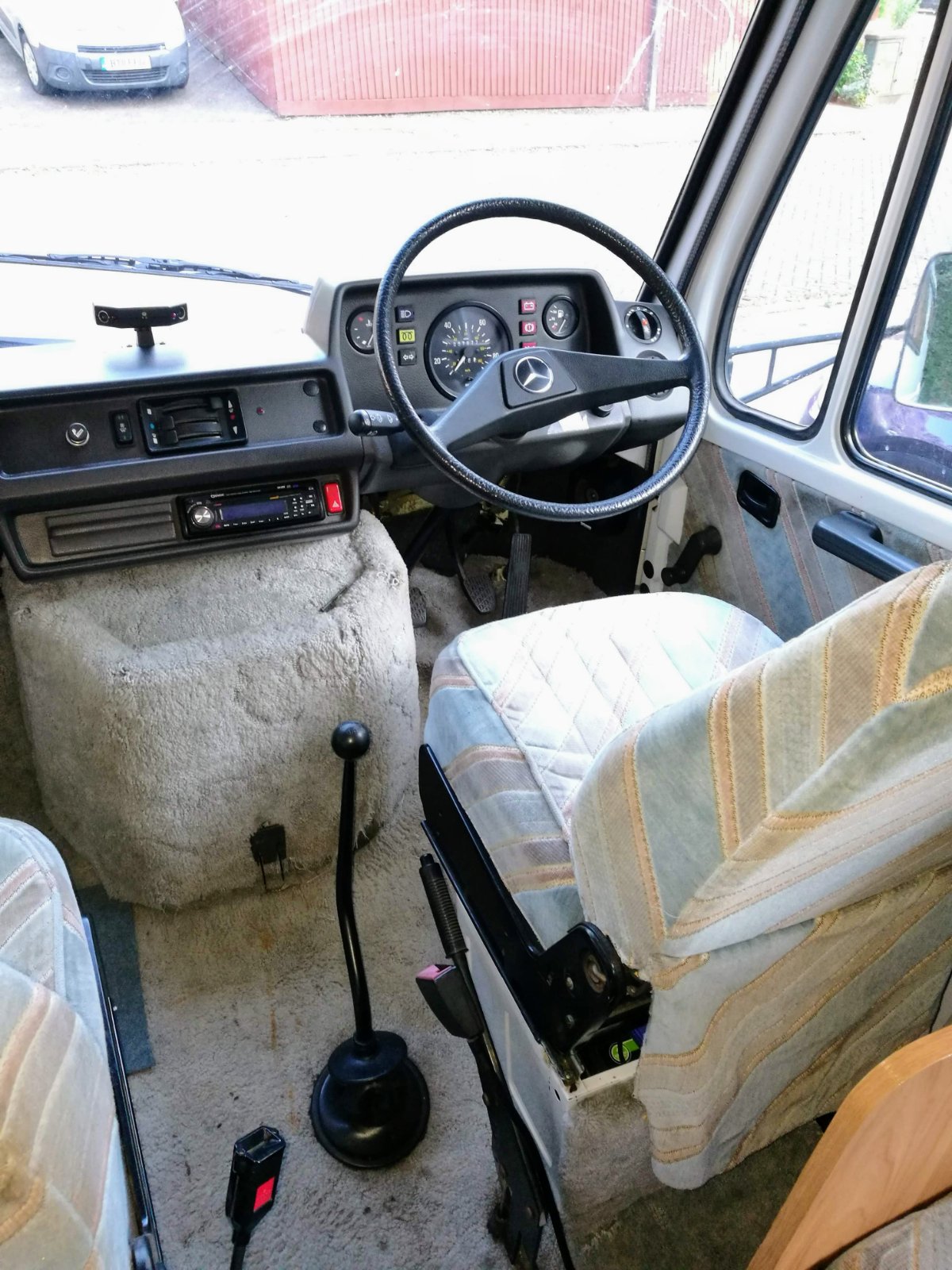

The main thing is the Gearbox, the selector is so bad i think describing it as vague would not be doing it justice, gears are selected by thrusting the lever swiftly but gently in the correct direction to use the momentum of the mechanism to find the required gear, you can feel no gate as such but then the whole linkage set is worn horrifically and required re bushing.
if i remember correctly the Merc had 1st on a dogleg (racing gearbox?) but was a very low ratio which made getting off the line a bit of a scramble.
The Merc is noisy by modern standards. You can't ignore the fact that the cylinder head is immediately to the left of your left knee, and the gearboxes whistle in fifth.
You remember correctly...
Lovely change in this in that sort of precision engineered in as far as commercial vehicles could be at the time way. First is as you say quite low geared, as is second. So you're generally in third by the time you're half way around a roundabout.
Probably the biggest surprise for me in this is the fact she rides as well as she does, much more like an old coach than a van. Steering here is very pleasantly weighted when driving, but is rather weighty (less so than the Lada!) when parking. It's not problematic, but you do learn to feed the wheel through your hands when parking quite quickly.
The cab is quite a different place and is one of the few places where the origins of the Merc T1 being back in the early 70s shows compared to the relatively modern design of the Talbot...
We seem to have a similarly afflicted thermostat however...this is the highest I ever see on mine currently.
I do have a new stat on hand though, just need to get around to fitting it.

The needle on the temp gauge should sit just above the first white line if my memory is correct, i used to love the odments tray on top of the engine cover............in fact, i still have a temperature guage out of that Merc somewhere, i know i saw it recently, the cab of the merc is rather well put together, the Talbot..............Meh.
