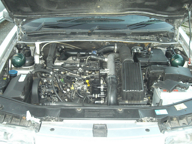

Scrubs up ok doesnt she, does anyone know where the cover goes thats on top of the battery in the picture, i didnt pay any attention at all when i pulled it off, i think it goes on top of the abs block but cant see where it clips on.
Jim ive thought long and hard over it and it comes down to one simple thing, time. I love the Activa, i know people slate them but this one has enough go to be fun and looks great and has proved very reliable, all the faults im sorting now were there last year when i bought the car except for a worn inner CV joint. ( arrived today Robert and is now fitted so thanks a lot for that) The trouble is now with Ellie time is short and although the xm is nowhere near as quick as the xant or as good in the bends i do prefer it for many reasons but mainly because its a long standing companion thats in great condition, if i keep the activa i will want to start getting realy anal with it and i cant afford to be like that with two cars especialy now i have a company car.

I know where that cover goes Dean! It goes on the side of the fuse box facing the battery....
