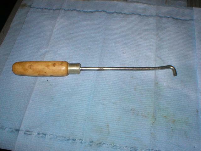

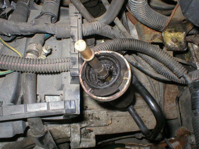

As long as you're very careful with the slave Dean, you'll not need to touch the wet bits of the hydraulics
In any case they're sealed for life and a bit of a game to bleed... So long as you're careful with the push rod and don't allow the clutch pedal to move whlist the slave is out then you'll have no worries at all.
Remove BOTH driveshafts complete. The bit of extra work will make the whole job ten times easier...

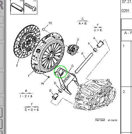

This is a diagram of the clutch, the green circle shows the cup in which the slave pushrod sits:
This is my special tool for re-engaging the release bearing:
And here's a picture of the slave showing the pushrod...

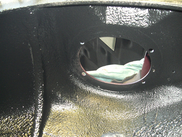

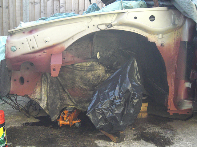

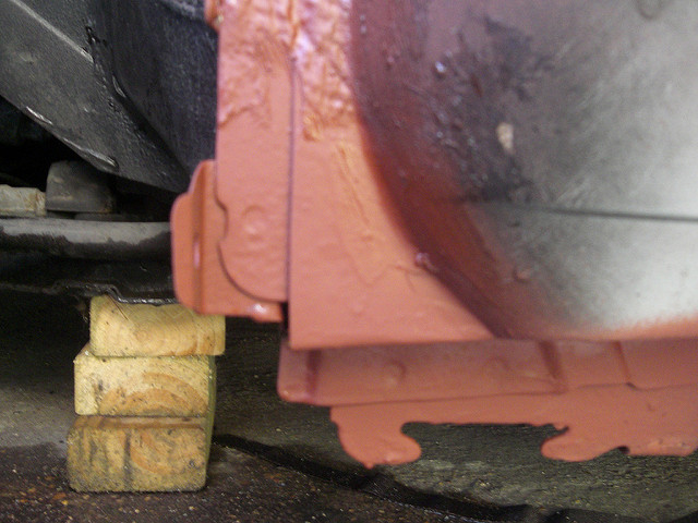

At last i had a few hours to get back on with the xm today, first port of call was to break out the rotary brushes and other abrasives to clear off all the old stonechip and surface rust forming underneith, there was plenty of new rust just starting even though the top coat was unbroken and clean, particular attention was paid to the front of the cills where a lot of panels meet, rustcure was then applied and the areas primed ready for stonechip.
first attempt2 by Deanxm, on Flickr
first attempt4 by Deanxm, on Flickr
first attempt5 by Deanxm, on Flickr
Then i sprayed 3 coats of stonechip on (about half a litre) and the finnish is pretty good, it will tie in well by the time ive done all the cills too.

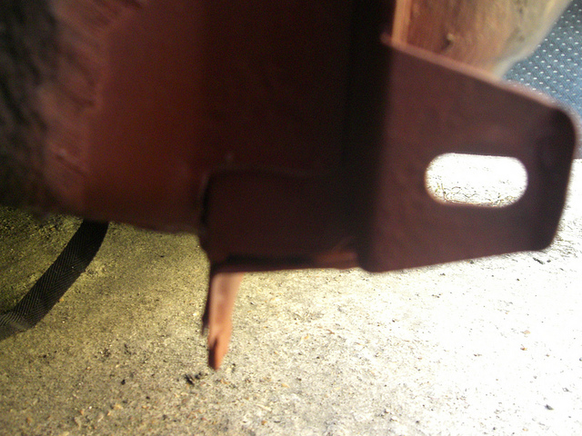

Ive got some dinitrol 3125 coming to do inside all the cills and box sections, only 3 litres for now as its bloody expensive but looking round its the best stuff for the job, this will be applied before spray waxoiling the underside to seal the cavity plugs, the exhaust is already off along with all the heat sheilds ready for application.

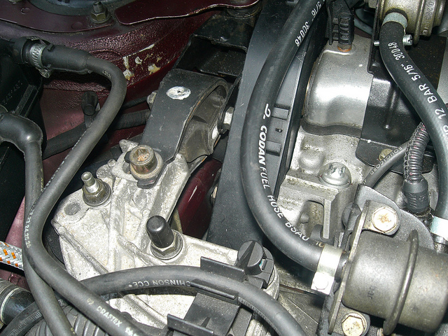

Got the engine mount changed back to the correct one too, it hopefully will transmit far less noise, i was never really happy with the doughnut style mount used on almost all other psa cars.

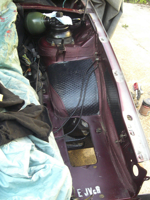

And finaly i have been applying lots of sound deadening mat, i will be doing so to the boot especialy as with the seats down a lot of noise is transmitted from there. Also i have found some nice felt matting and i notice a lot of cars have this applied to the wheel arch liners nowdays to reduce noise so i will be applying some of that too.
first attempt8 by Deanxm, on Flickr

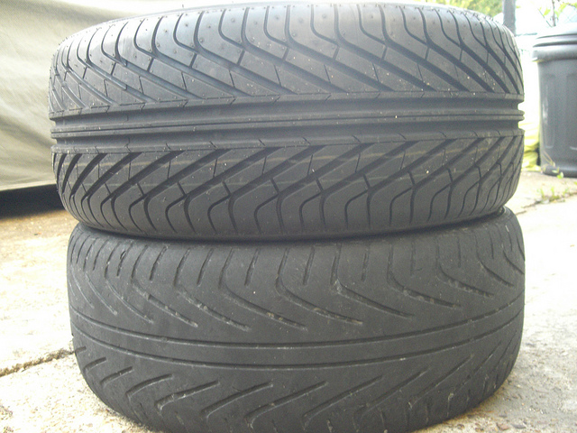

In Activa related news i have pulled the wheels off it ready to take them in to have my £25 bargain pair of tyres fitted, the old ones where pretty shot, thats for a pair of 215/40/17's on a W, if there was a dancing smilie, i would be using it right here
first attempt9 by Deanxm, on Flickr

Just picked them up, one didnt even need ballancing the other only had 5g on it. In fact i will be interested to compare them to the P-zero nero i last bougt for the xm, they were a little over £110 each, the sinfull ones i have just bought retail at just under £40 each in the same 215/40/17 size, i wonder if the grip really is as different as the price.........
