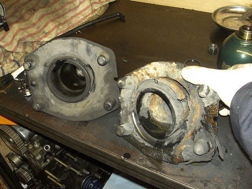

heres my strut top pictures, the first is of the new and the old showing delamination and the following one is of the tearing of the rubber on the other side of the same strut top (there wasnt a whole lot holding it together :lol: )
The other strut (N/S) although not pictured here has bad rust/hole issues rather than rubber trouble. oh and try not to worry yourself too much :) .

Cor! You were lucky there Dean. They were suffering a bit of advanced decay :twisted:
Time to send them to Lithuania now and see what our Strut Top friend can do with them!

Those struts do look rather grim dean! :shock:

Yes they were grim, i posted these pics up in the strut top thread on CXM but was beaten hands down by Steelcity, he had a really bad one!!!
I will be getting these repaired, but i will have the xm ones done first, its getting on for 20years of age now and every other rubber component has needed replacing, they look perfect but a sudden tearing of the rubber could easily happen with no warning after so many years of use.
The new Activa ones (pictured) are good but the rubber is still old, even being rust free they may not be spared other failure modes.
