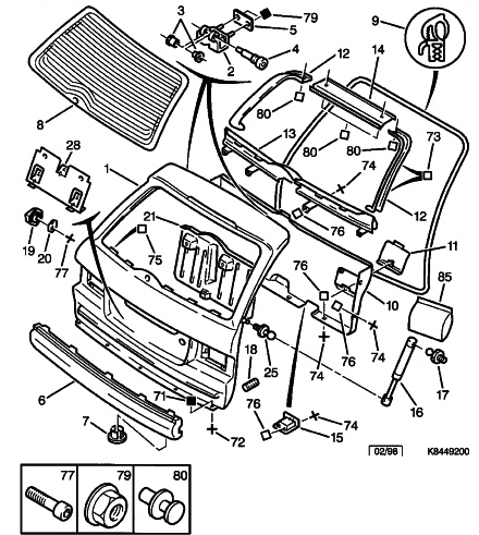

Well thank you H
I've just reminded myself precisely what the fastening is on the hinge and
of course it's a pair of nuts holding the hinge 'box' on either side not Torx
as I mention earlier. The Service net illustration shows how the hinges pin
into the roof (item 2) locating the tailgate even after their fastening nuts
(item 79) are removed (IIRC 10mm). I'd leave item 4 well alone! There is
a large spreader washer (item 5) that needs to be prevented for dropping
into the roof box section.
Andrew

Many thanks for the detailed guide and the drawing - "a pictures worth a 1,00 words".
The work will be done by a small bodyshop a few doors away. Steve the owner will do anything from cheap and cheerful to meticulous - dummy seams right down to reproduction spot welds! I'm sure he'll be glad of a decent-sized job where cost isn't the only consideration.
Guy

Update
The other party's insurers have admitted they notified DVLA that they had written off the cars as soon as they received the 'engineers' report. I've never had an offer from them just a cheque - vigorous complaints pending!
I've banked their cheque as it arrived the day the car went into the body shop.
To keep the cost down and to be certain of the electrics, I swapped the tailgates myself and left the trim off to make the body shop's job easier.
I got the car back Saturday lunch-time - a beautiful example of what a good panel-beater can do. Sadly the replacement tailgate had been leaking like a sieve (water-shield literally hanging off) and the high-level brake light was bust and leaking too - I've spent today re-fitting the trim and making a proper job of the tailgate. I'll write swapping tailgate and post some pictures later this week (working 10 hour days last week).
Guy
